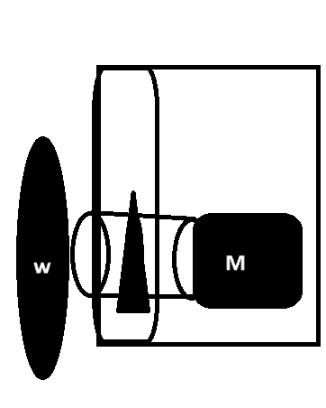

cahewstone
Basically I am calculating how many bolts to use for an aluminum plate that connects to the shaft of a motor that drives a wheel. The shaft is connected by bearings to the plate, so it should transmit very little moment to the chassis through the plate, but I don't know if I'm thinking about it right, especially when the wheels connected to the motor start running (should I maybe push the bolts with the maximum torque of the motor at that instant?).

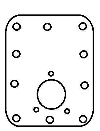

Diagram? Not sure of the arrangement of plate to shaft.
Ok, sorry for the simple drawing. I hope it helps. First, the plate that conect the shaft with the robot.
So, the big hole is where the shaft pass, the three little holes araund are part of the shaft holder. The other holes are for attaching the plat to the robot. The robot has a motor that conect with a wheel
If the shaft passes through an efficient bearing, then torque will not be transmitted to the plate. Only translation forces will act in the plane of the plate.
There will be vertical forces on the bearing, due to the weight of the robot and its load. There will be a horizontal force on the bearing, due to the drive or braking torque applied to that wheel through that axle.

Thanks for your answer! I'ts clear to me now, that the torque should be insignificant. Taking advantage of the previous question, I think it could be useful to consider the maximum force generated by an impact (such as a fall for example). Do you have any idea how I could estimate it well?
