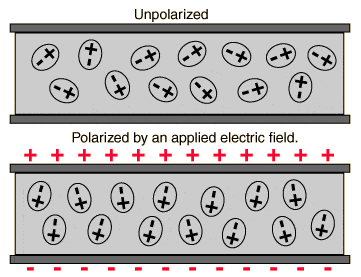

The secret to understanding capacitors is to realize that the energy is stored not on the plates but in the dielectric.
Good dielectrics have polar molecules that the electric field 'twists' out of their preferred alignment.
http://hyperphysics.phy-astr.gsu.edu/hbase/electric/dielec.html

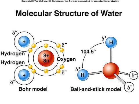

Water for instance is a very polar molecule. That's why water has a dielectric constant 80X that of free space.
Why free space has a dielectric constant i do not know - there's nothing there to deform.
