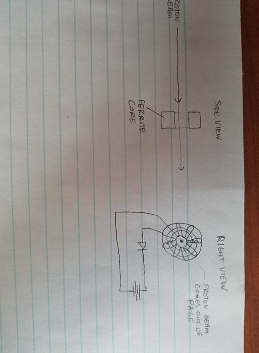

I envisioned something like in the attached sketch. Sorry if it's difficult to make out, but it's basically a ferrite core that has copper wire wound around it. The proton beam is a moving charge and therefore generates it's own magnetic field according to Biot Savart law. When the beam passes through the ferrite core, the beam induces a magnetic field in the core. This magnetic field induces a current in the wire wound around the ferrite core. This current passes through a diode and charges some sort of battery. I'm trying to figure out how much of the beams energy can be taken and stored in the battery. I would ideally like to be able to convert almost all of the kinetic energy in the beam into stored energy in the battery.
  • Hand-drawn sketch: a side view shows a proton beam arrow passing through a square ferrite core, and a right view shows a coil wound around the core with a diode and battery in a closed circuit, labelled 'proton beam comes out of page'.

Does it need a full wave rectifier? The transformer is fed a pulse train via the beam pulses, so the transformer input would peak at the beam current and have a minimum current of 0 A. The current should only ever be going in one direction, right?
If I power up your toroid, there's no magnetic field in the interior, right? That's what you drew.
Therefore, if I put a field in the interior, it won't generate a current.

I think he's firing the pulsed beam through the middle of the CT. That will induce a voltage in the toroidal coil of the CT.
No. It sounds like you don't understand how transformers work yet.

Oh whoops, yeah you're right, it does need a F-W rectifier. It's been a while since I've worked with transformers.
