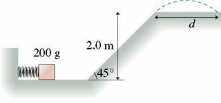

The spring in the figure has a spring constant of 1100 N/m. It is compressed 16.0 cm, then launches a 200g block. The horizontal surface is frictionless, but the block's coefficient of kinetic friction on the incline is 0.180. What distance D does the block sail through the air?
heres a picture that should help.

Well? Show your work and indicate where you got stuck.
Hint: Use a combination of energy methods and projectile motion kinematics.
Well, I first tried to use work and kinetic friction to find the horizontal distance of the hill however once I reached to the end of my calculations I figured that what I was doing found the the entire distance that the block travels. So then I tried using the conservation of energy to find the velocity of the block at the top of the hill but I don't know how to incorporate the coefficient of friction into that equation.
I figure that If i can find the velocity of the block at the top of the hill then the rest of the problem is cake with kinematics
Figure out the force of friction and then the work the friction does on the block as the block slides up the incline.
Would the distance I use for W=Fd in this equation be the horizontal or vertical distance. Because if its the vertical distance then i can solve for v but if its the horizontal then i have 2 variables in my equation.
What direction does the block move?
You're given the angle of the incline.
Ok, I found the velocity of the block at the top of the incline. Which kinematic equation and in which direction should i start?
From the moment the block shoots off the incline, it's a projectile motion problem. You have the initial speed and direction.
