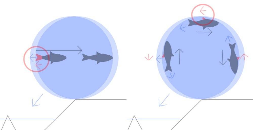

Im having a great difficulty distinguishing any difference in the following 2 scenarios (except that the fish will run into the wall after a certain amount of time in the scenario on the left)...
(In both scenarios the fish uses their tail fin to push directly off the glass)
  • #88
The scenario on the left is incorrect because the fish cannot make the ball move by pushing on it. All it can succeed in doing is making the water within the ball flow backward just enough to match its forward momentum.
  • #89
  • #90

I believe this one may be more clear.
I believe you are saying the depiction on the left is not possible if the fish pushes off the glass (all fish water balls are floating in water in the following diagram). So what about the two depictions on the right? On top, the fish pushes off the glass, the fish accelerates, the glass doesn't move at all during the coasting phase of the fish. The energy transferred to the water by the fish per second can be stated (where rho is the fluid density of the water) ##W=(1/2)*C_d*rho*A_f*V^3##, and the fish retains some of the kinetic energy it acquired in the push when it hits the opposite wall. On the bottom right, The energy transferred to the water by the fish per second can also be stated (where rho is the fluid density of the water) ##W=(1/2)*C_d*rho*A_f*V^3##, but there is a hole for the fish to escape and so the glass ball acquires momentum via ##M_1V_1=M_2V_2##.
Is the scenario on the bottom right valid?
  • #93
metastable said:
I believe you are saying the depiction on the left is not possible if the fish pushes off the glass.
Correct.
That one is fine. The ball never moves. Not during the push off. Not during the coasting phase. Not at impact. Never.
There is a hole through which the fish escapes. You have accounted for that momentum flux.
Through that hole water enters. You have not accounted for that momentum flux.

It's already been acknowledged that the fin action on the right circled in red (applying tangential force directly to the glass via the friction with its fins) causes the ball to roll.
Can someone explain why the fin action circled on the left (applying direct force with its fin against the left side of the ball) is not exactly equivalent to applying tangential force via friction with its fin at the top of the ball?
