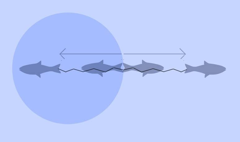

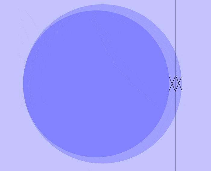

  • #106
metastable said:
It's already been acknowledged that the fin action on the right circled in red (applying tangential force directly to the glass via the friction with its fins) causes the ball to roll.
Can someone explain why the fin action circled on the left (applying direct force with its fin against the left side of the ball) is not exactly equivalent to applying tangential force via friction with its fin at the top of the ball?
Conservation of momentum. No external forces means no motion of the center of mass. That's the easy argument. It is bulletproof.
This one of the nifty things about conservation laws. They let you skip past the pesky details and go straight to the conclusion.
The harder part is seeing how this is enforced mechanically. It is especially hard if one hand-waves the water away as being negligible. Because the ball rigidly encloses the fish and water, any forward motion by the fish relative to the ball must also involve an equal and opposite motion of the water relative to the ball. In order to get the water to flow rearward, either the fish or the ball (or both) must push the water rearward.
1. If it's the fish pushing the water rearward, we just have the fish swimming. No push-off from the ball. No motion of the ball.
2. If it's the ball pushing the water rearward, we have equal and opposite forces on the ball. No motion of the ball.
Either way and in any combination, the ball does not move.

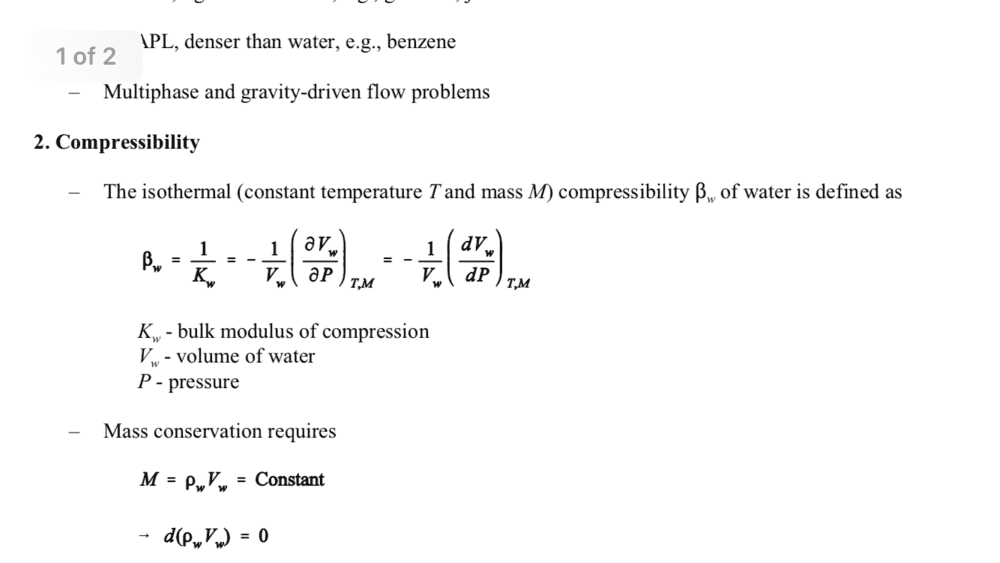

  • #126
Isn’t it necessary to drop the assumption the water is incompressible? Can’t the water store and release internal stress energy in the form of differential pressure in different areas of the ball? This CFD animation clearly shows what appears to my untrained eye to be pressure waves in the wake of a simulated fish...
Likes pinball1970
  • #127
If you do, moving the CoM relative to the ball is possible and we can also use the hamster method.
Likes jbriggs444

  • #130
metastable said:
^ @A.T. I don't think the equation is invalid in the context I used it. @jbriggs444 specified constant motion in the scenario I was responding to.
Okay, but your method was involving accelerating the fish by pushing of the wall. You cannot use the steady state drag equation to analyse that.
However, once you drop the incompressibilty of the water or the perfect rigidy of the ball, it's trivial that propulsion is possible.
Likes jbriggs444

  • #139
Vanadium 50 said:
incompressible fluids are compressible (or is it the other way round?) then you're right.
I thought referring to water as incompressible is only an approximation relative to the compressibility of gases. Water actually can be compressed, can it not? Obviously we are talking about potentially constructible robotic fishes— because real fish use swim bladders filled with air to maintain neutral buoyancy, and so do not meet the criteria of the current discussion— moving the glass while having uniform density with the water.
  • #140
Re-read #130 for comprehension this time.
If we treat water as compressible then we can simply put a vacuum-breathing super-hamster in a water-filled ball, have him drink all the water and excrete it under enormous pressure into his bladder. Then he can trot around the room just like a regular hamster.
If we treat the ball as non-rigid then we can simply have the super hamster extrude legs from the ball and walk around on all fours.
Treating the ball as non-rigid and the water as compressible reduces the problem to a triviality.
Treating the ball as rigid and the water as incompressible makes for an interesting toy problem that the rest of us were trying to discuss.
