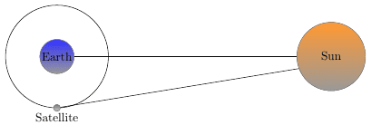

Lately I've been interested in tikz, which is a latex extension.
Since I would still like some way to quickly draw something in a post, I'd like to recommend tikz.
It is a latex extension of which I hope it can be installed as part of the latex engine.
I have no clue however if it can be installed as a plug-in in vBulletin.
Let me give an example.
The following latex code:
Code:
\begin{tikzpicture}
\draw (-4,0) -- (4,0);
\draw (-4,0) circle (1.5);
\draw (-4,-1.5) -- (4,-.2);
\fill[draw=black!50,top color=blue!80,bottom color=black!40]
    (-4,0) circle (.5) node {Earth};
\fill[draw=black!50,top color=orange!80,bottom color=black!40]
    (4,0) circle (1) node {Sun};
\fill[draw=black!50,top color=gray,bottom color=black!20]
    (-4,-1.5) circle (.1) node[below = 1pt] {Satellite};
\end{tikzpicture}
yields this picture:
To get this picture to work, it suffices to install MikTEX in Windows and simply try to render the latex code (in a document wrapper that includes \usepackage{tikz}).

That code looks ridiculously complicated to produce such a simple image.
