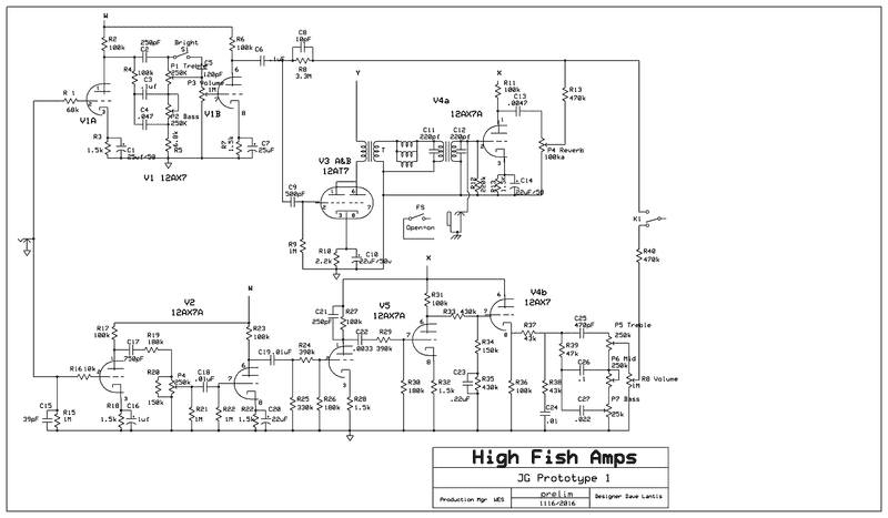

Hi,
I am struggling with this a bit. I think this will work but I am not sure. Can you guys take a look and see if I have made any obvious mistakes. The B+ voltage should be around 480 VDC loaded. I am still working on the channel switching.
http://[ATTACH=full]200152[/ATTACH]

  • Schematic of a high-gain guitar amplifier preamp with vacuum tubes labeled V1 12AX7, V2 12AX7A, V3 A&B 12AT7, V4a and V4b 12AX7A, and V5 12AX7A. Title block reads High Fish Amps, JC Prototype 1.

  • Schematic of a guitar amplifier preamp titled High Fish Amps, JG Prototype 1, with vacuum tubes V1 12AX7, V2 12AX7A, V3 A&B 12AT7, V4a and V4b 12AX7A, and V5 12AX7A, plus tone stack controls labeled Treble, Mid, Bass and Volume.

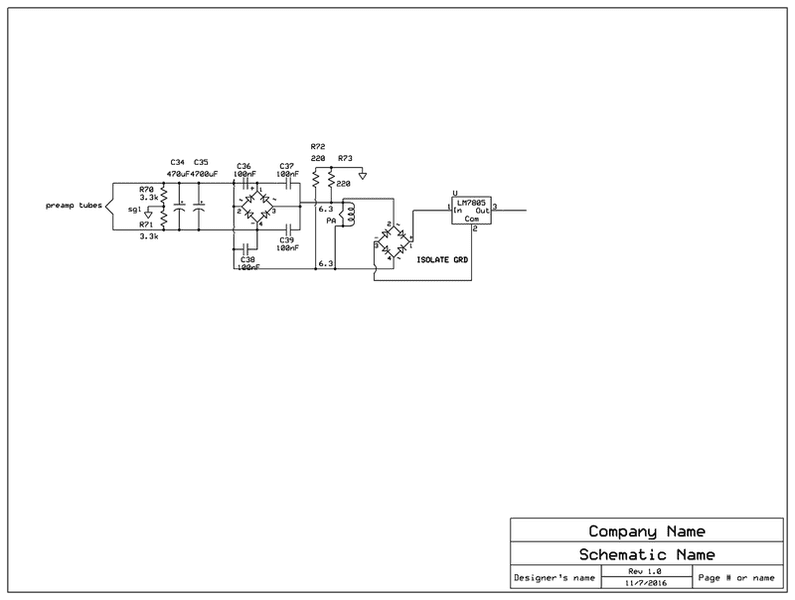

  • Schematic of a preamp tube power supply: input from preamp tubes through R70 and R71 (3.3k) and filter capacitors C34 470uF and C35 4700uF, a bridge rectifier with C36, C37, C38 and C39 100nF, then R72 and R73 (220), a 6.3 heater winding, a second bridge rectifier, and an LM7805 regulator with an ISOLATE GRD note.

  • Schematic of a guitar amplifier preamp titled High Fish Amps, JG Prototype 1, with tube stages V1 12AX7, V2 12AX7A, V3 12AT7, V4a and V4b 12AX7A, and V5 12AX7A, plus tone stack controls labelled Treble, Mid, Bass and Volume.

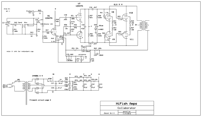

Sorry . I posted the preamp section twice and don't know how to remove it. Here is the PA.
Guitar amplifier schematic titled HiFish Amps Collaborator, prelim, dated 11/4/2016, showing a 12AX7 preamp stage, a 12AX7 phase inverter, and 6L6 power tubes V10 and V11 with output transformer, plus a power supply section with 1N4006 rectifier diodes.
Output transformer secondary 'T' is floating, it has only one feedback connection, is the other terminal grounded?
No ceramic bypass caps on the LM7805 regulator. It will howl at the moon.
The LM7805 has no reservoir capacitor.
The LM7805 needs a minimum input of 7.5VDC but it has only 6.3VAC.
6.3VAC * Sqrt(2) = 8.9 volts peak, less two diode drops of 1.1V each, in bridge = 6.7 volts
You have run out of voltage headroom. Regulator will always be in drop-out.
Headroom decides value of reservoir capacitor. C = I * dt / dVripple
Edit: Or is that secondary 6.3-0-6.3 giving 12.6VAC without showing the CT ?
Hi,
Thanks for the feedback. Yes the other terminal is ground, just not shown. I will go back and take another look at the LM7805 issue. I may have to adjust several things because I bit the bullet and ordered high end Mercury Magnetics transformers. $658.00 plus the shipping from Cali to Florida. MM is pretty pricy. I was shooting for around 480 to 500 VDC loaded.
All the parts should arrive next week by Tuesday.

The ISOLATE GRD is connected to Ground thru R72, R73, and the rectifier bridge.
With the values shown, the filter caps C34, C35 will result in 1.5Vpp ripple to the preamp heaters.
The whole complex around V6 and the feedback loop makes me go "unstable!" Exactly where (physically) are you connecting the output transformer secondary to ground? That detail could be the difference between "motorboating" and silent when no signal is present.
Again, I would never design an amplifier without current feedback in the output tubes (at least do a DC feedback to stabilize the thing). I am also extremely wary of designing a feedback from the transformer secondary due to the phase shift in the transformer. My favorite feedback in the output stage is to the g2. Take a look at http://www.dogstar.dantimax.dk/tubestuf/driverpa.htm
