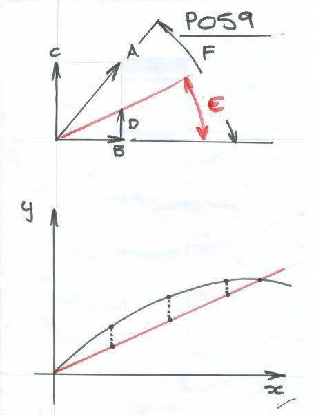

Imagine a point on the hill directly below the projectile, this point has a constant vertical velocity during the flight ( you can figure it from the projectile behaviour )
Then you can ignore horizontal activity and treat the problem as following :
The projectile and the point are launched vertically at the same time, the projectile having the greater velocity ( which is the vertical component of the launch velocity )
Have a look at this sketch :
A = launch velocity in m/s
B = ( constant ) horizontal vector in m/s = cosine F * A
C = vertical vector in m/s = sine F * A
D = ( constant ) vertical velocity of point on incline directly below the projectile = tan E * B
E = incline angle in degrees
F = launch angle in degrees
t = elapsed time in seconds
For impact point :
( D * t ) = ( C * t ) + ( ½ * - g * t ² )
Then :
( D * t ) - ( C * t ) = ½ * - g * t ²
D – C = ( ½ * - g * t ² ) / t
And :
( D – C ) / ( ½ * - g ) = t
With t you can locate the impact point x and y coordinates

Thank dean barry for replying! That is what I was doing at the begging since I understood from the problem that the wanted the height (the value of y). But what the problem asked was to find the distance from the bottom of the hill to the hitting point along the hill. They are asking for the distance "d" in my drawing.
