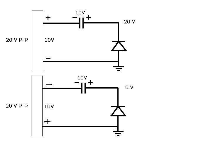

Are you wondering why it is charged to peak instead of what? Peak x 2?
In the attached diagrams, during the first negative half cycle (ie like the bottom diagram), the capacitor voltage will follow the input voltage until the voltage starts to drop. The capacitor cannot discharge back into the supply because the diode cannot conduct backwards.
So, the capacitor holds the peak voltage of the supply.
The capacitor has no way of losing this charge, so it now appears in series with the source voltage.
See attached diagrams. The box on the left is a transformer giving 20 volts peak to peak, or 10 volts peak. Assume perfect diodes.
In the first one, the capacitor is charged to 10 volts and the input voltage is rising to a peak of +10 volts, so the output is +20 volts.
In the second one, the capacitor is still charged to 10 volts, but the input voltage is 10 volts negative, so the two cancel out and the output is zero volts.
So an input that was varying from +10 volts to -10 volts is now varying from +20 volts to zero volts. This is what a clamp circuit does.

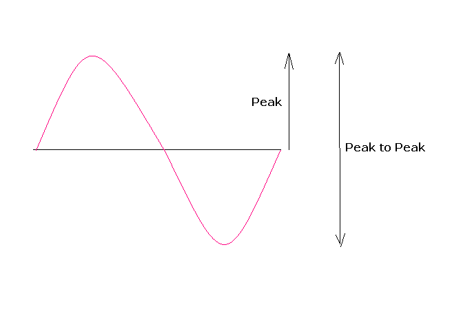

thx for ur reply but still what peak to peak means and what's difference between peak to peak vlaue and peak value
A sinusoidal voltage as a function of time is written like this:
V(t) = A sin(wt)
Where A is the amplitude, and omega "w" is the angular frequency in radians per second.
The value A is called the peak amplitude. The peak-to-peak amplitude is 2A, because it is the difference between the positive peaks at A and the negative peaks at -A.
A - (-A) = 2A
Does that clear it up for you?
See attached picture.
