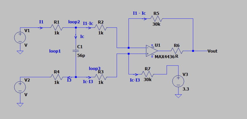

I keep trying to solve the following circuit with equations but i always fail and never able find a final solution, i am trying again now let me see if i can finish
Now i plan to solve for I1, I2, I3 check the frequency response, am i in correct direction?

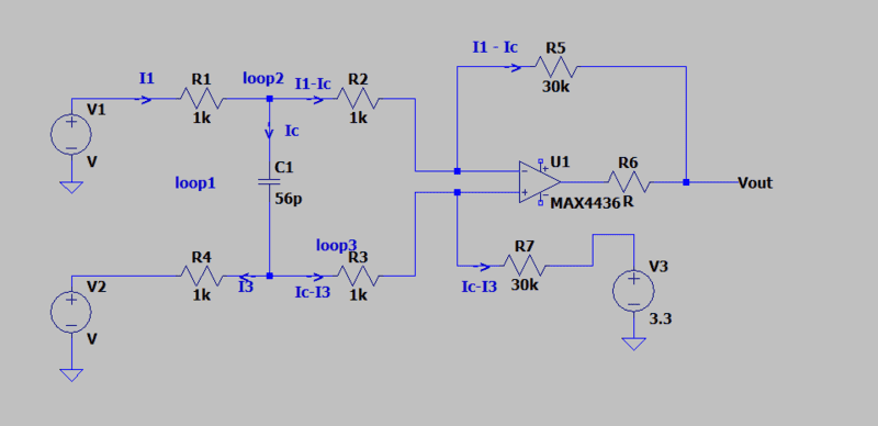

View attachment 329618View attachment 329622
##Z_c = -\frac{1}{j\omega c}##
You have some sign errors in eq3.
Thank you i have updated to
##I_1e^3 + I_c(Z_c+31e^3) -31e^3I_3 + (V_{ref} -V_1) = 0 ##
I will solve for equations and frequency response, i am not sure if i can solve manually or i need to take help of tool.

Yikes. It's best not to make up your own notation, especially when asking for help from others. It is also better not to substitute numerical values into equations until you have arrived at your solution with variable names. That's when you substitute in the numbers (with "k" = 1000) and generate your numerical answer.
Pro tip - This is really important IMO!
Don't formulate your equations with numerical values for the constants like resistors or voltage references. Everything should be either a variable or a constant initially. Then do as much algebra as possible to find a simplified form BEFORE you put the numbers in.
So, for your first equation, I would have written ## I_1R1+I_cZ_c+I_3R_4+V_2-V_1=0##.

Very challenging equation to solve but arrived at the following equation for I1 current
I will try to plot frequency and see if i am in correct direction.

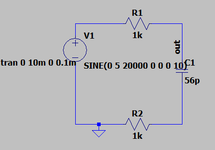

With LTspice i tried to simulate only one portion of the schematic
The filtering happens only at ##f=\frac{1}{2\pi rc} ## I substituted r = 2K, C = 56PF
f = 1.4MHz. Why do we need to attenuate at this frequency?

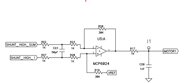

The circuit is a low-pass filter. It attenuates higher frequencies. That keeps RF and EMI out of the op-amp. What is the gain⋅bandwidth product of the op-amp used?
The opamp is MCP6021 opampdatasheet
The data sheet shows 10MHz. Is it related with 1.4MHz?
GBWP = 10 MHz;
Circuit gain = 15 ;
BW = 10 MHz / 15 = 667 kHz.
Which analysis type did you use this time? :wink:
What variables did you plot?
