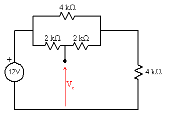

In the following transient circuit, assume at t<0, the circuit is at steady state.
Assume vc(t) is the voltage across the capacitor and v0 (t) is the output voltage as shown:
Find (a) vc(0+) (b) vc(∞) (c) vc(t) and (d) v0(t) for t>0

I am pretty first stuck right at the beginning
A)
For this part, the capacitor will act as "open", so I remove the capacitor.
But then I have no idea how to find the voltage.

Just rearrange the layout a bit and I think you'll find an approach:
Circuit schematic: a 12V source on the left feeds a network of a 4 kΩ resistor on top and two 2 kΩ resistors in series below, with a node labelled Vc between them, connected to a 4 kΩ resistor on the right.

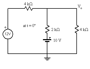

Looks okay except for (d). Draw the equivalent circuit for time > 0. Initially the capacitor begins with its initial voltage of 10V from part (a). So pretend it's a voltage source at the instant t = 0+. What then is Vo initially?
It seem to me that if we go on to find Vo(0+) we then have to deal with superposition since there are 2 voltage source?
actually in the problem statement, there is a hint for part d, which says apply KCL at top node.
and I don't really know what to do with that hint and how to use equation from Vc(t) to find Vo(t)
Draw the circuit for the instant that the switch opens, replacing the capacitor with a voltage source of value equal to the initial capacitor potential:
Circuit schematic labelled at t = 0+: a 12 V source with a 4 kΩ resistor on top, a branch with a 2 kΩ resistor in series with a 10 V source, and a 4 kΩ resistor on the right with output node Vo at the top right.
Use whatever circuit analysis techniques you want to find the initial value for Vo. One method is to use nodal analysis (KCL) at the output node. Similarly, find Vo for time >> 0. These two endpoints are connected by an exponential function with the same time constant as the capacitor voltage function.
