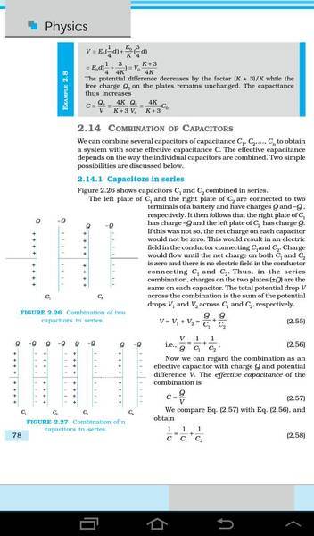

Why does the potential drops when charge pass through a capacitors connected in series.
I'm not quite sure what you're asking. Could you clarify what you want to know?
See, we have seen that capacitors are connected in series the same charge flows through each capacitor but when charge passes through each capacitor its potential drops.so why do this potential drops
Consider two capacitors in series. If they are connected to a 12 volt battery, then obviously the total voltage across both capacitors is only 12 volts, as that's all the battery can supply. Since the voltage drop must add up to 12 volts, then each capacitor must be charged to less than 12 volts individually. If they are of equal capacitance, then both would be 6 volts. Since capacitance is c=q/v, we can re-write this as q=cv to find the total charge given by this reduced voltage. Since the voltage is half what it would be if we had a single capacitor, that means that the total number of charges on each capacitor is also halved.
Remember that the number of charges moving onto or off of the two plates in a capacitor always remains equal. Since the middle two plates (one plate of each capacitor, connected by the conductor between the capcitors) are separated from the rest of the circuit by the dielectrics, no charge can leave them. In the end, the first plate of the first capacitor and the last plate of the second capacitor have equal and opposite charges, but at half of what a single capacitor would have. So this series of 2 capacitors acts like a single capacitor with half the capacitance.

kartikwat said:
https://www.dropbox.com/s/1t18mlwb3agnxq0/Screenshot_2014-07-15-15-41-35.png
What does the following paragraph convey on capacitors in series,i think it is not clear.
WHAT paragraph?
Don't use dropbox; instead, attach the diagram directly.
This is what i am trying to understand
Yes, this says exactly what Drakkith said, except that it shows you the math and gives the generalized case rather than a simple example as Drakkith did. I would suggest that you look at Drakkith's explanation again, since it is easier to understand than the general case, then when you've figured that out, the general case should be easier to understand.
There is potential drop between the plates of the first capacitor because there is electric field between them due to the equal and opposite charges in each of the plates. The potential drop V between two points A and B usually is defined as the integral [tex]V_{AB}=\int_A^B\vec{E}\vec{dl}[/tex].
Where the path of the integral can be any curve that connects the points A and B. It doesn't depend on the choosing of the curve as long as we consider the electrostatic or quasi static case. You can see that the above integral is not zero, assuming that the electric field between the plates is homogeneous and vertical to the plates , the integral is equal to E*d where d is the distance between the plates.
Similarly there would be potential drop between the plates of the 2nd capacitor.
