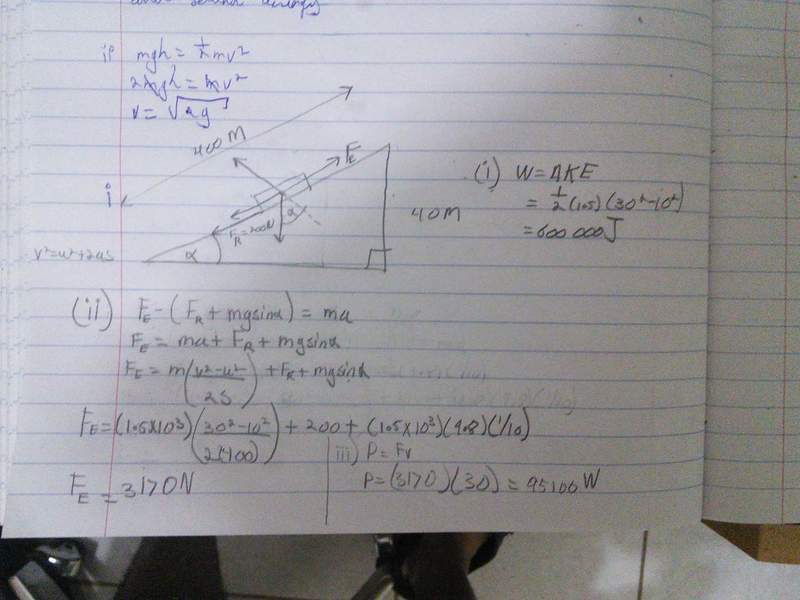

My question and attempted solution are in the pics below...not sure if what I did was correct though :/
I was thinking that the work done would have been equal to PE+Change in KE + Energy Lost to friction...but not sure how to calculate the energy lost to friction as I'm not sure if it has to be calculated in a specific form eg heat

Work performed by a force = magnitude of the force x distance moved in the precise direction of that force. The energy expended will probably mostly end up as heat, but that is not important here.
