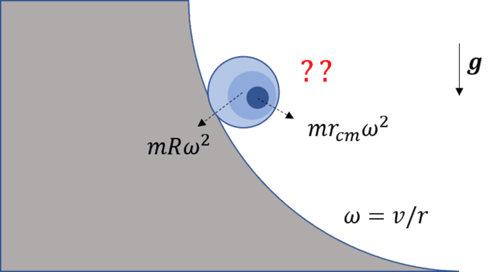

Let's say we have a cylinder of radius r with non-uniform density, resulting in a center of mass shifted away from center of geometry. Let's assume that this center of mass mid-way between center and circumference. So, r_cm = r/2.
Now, let's say this cylinder is rolling down on a curved path of radius R + r. Assume no slip condition.
What is the centripetal force on this cylinder? Does it have "two centripetal forces", from which we find a resultant?
There are no equations here.
My initial attempt: Total Centripetal force on the cylinder would be given by $$\textbf{F}_{net} = mR\omega^2 \textbf{e}_1+mr_{cm}\omega^2 \textbf{e}_2$$ where the vectors e_1 and e_2 have magnitude 1 and point radially outwards (and continuously changing as the cylinder rolls down) as marked in the sketch below. Please advise. Thank you.
That is a strange problem. First of all, what is definition of a centripetal force acting on a rigid body ?
I assume you mean R>r.
Is there any guarantee that the cylinder will remain in contact with the surface?
As @wrobel asks, define centripetal force; but first define centripetal acceleration.
I think that there are only two forces acting on the cylinder: the reaction force from the incline and the gravity

Yes, but centripetal force does not have to be one or the other.

As I wrote, given the velocity and the trajectory, it is better to start with the definition of centripetal acceleration. Multiplying that by the mass gives the centripetal force.

Let us have an inertial coordinate frame. For the cylinder I want to write the angular momentum equation about the origin of this frame. And how should I include the torque of the centripetal force into this equation? If it is force indeed, I must put its torque into the angular momentum equation
By definition, centripetal acceleration is that component of linear acceleration which is orthogonal to the velocity.
In principle, we can find the velocity and acceleration of the mass centre. But there is insufficient information here since we do not know the moment of inertia.
I think that notion "centripetal force" does not make sense for rigid bodies just for particles
