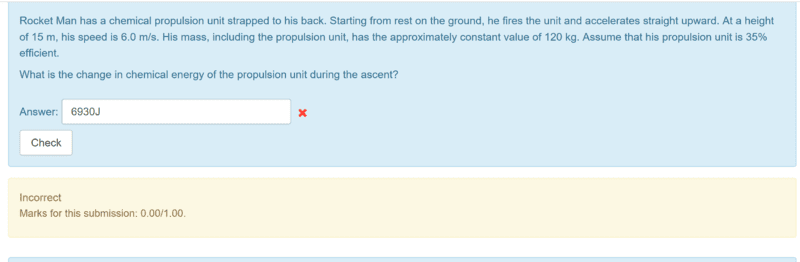

Change in chemical energy of rocket
The discussion centers on the calculation of energy in a rocket's chemical potential energy, specifically focusing on the total energy expended and the useful work done. The total energy expended is calculated as 19800 joules, with only 35% being effectively used, resulting in 6930 joules of useful work. Participants explore the relationships between energy expended, useful work, and efficiency, noting that wasted energy means work expended exceeds useful work done. The conversation highlights the importance of defining efficiency correctly and understanding the various forms of energy involved, such as gravitational potential energy and kinetic energy. Overall, the thread emphasizes the need for accurate calculations and understanding of energy relationships in rocket propulsion.
isukatphysics69
453
19800*.35 = 6930J

really need help here
isukatphysics69 said:
19800*.35 = 6930J
What is the relationship between the energy expended, the useful work done, and the efficiency?
Likes isukatphysics69
