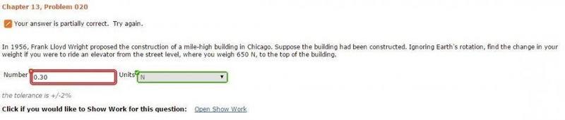

I attached picture.
I took the F=GMm/r^2 equation and did it for both Earth level, (radius of earth) with 650/9.8 as m
and for F at the top of the building, with r being the radius of the Earth plus a mile (1.609E3 m).
Please help?

Sorry if I didn't include enough on this question. I thought the attached photo was enough but I guess not.
I assumed that the only change would be the r^2 in the equation.
So I put it through the eq. F = GMm / r2
but just increased the radius. Now I know the weight would change as the rider moved, but it is merely asking for the difference between the top and bottom (earth level) of the building so I would assume (hopefully correctly) that 'm' is static and only changes in reference to distance from the Ecom
so, I had Emass=5.9736E24
Eradius=6.378E6
add on a mile
Etop=6.379609E6
I got for bottom 649.651N and 649.324N... but that isn't right...

Your answer is just a bit inaccurate, but I'm not able to follow your working from this bare description. Please post the details.

Your weight is 650 N on the ground, period. By how much will this number change 1609 meters up in the air?
You don't have to fool with G, M, or m, because all these number cancel out.

You have to be careful when the calculation involves finding a small difference between large numbers. Any little rounding errors can lead to major inaccuracy in the answer.
A safer way to proceed is to think in terms of fractional change. A change of 1 mile in roughly 4000 miles (no need to convert to km) is what fraction? Since the distance gets squared, how big a fraction should the change in weight be?
Problem in text format: In 1956, Frank Lloyd Wright proposed the construction of a mile-high building in Chicago. Suppose the building had been constructed. Ignoring Earth's rotation, find the change in your weight if you were to ride an elevator from the street level, where you weigh 650 N, to the top of the building.
@SteamKing > I assume it means weight in reference to gravitational pull of the Earth versus overall mass? I am not sure. Example answers from chegg and yahoo answers correlate with the answer I am getting. ..
@haruspex > Fearth = ((6.67E-11)(650/9.8)(5.97E24))/(6.378E6)^2
Ftop = ((6.67E-11)(650/9.8)(5.97E24))/6.379609E6)^2

Ah, a change of 1 in 4000 is 0.00025?
Right, so what fractional change should that lead to in weight?
650N >...0.1625N change...but its squared...so would change double to 0.325?
Yes.
So...what radius should I use...4000 is ok but with only 2% available lee-way I should use the most accurate possible. I do not like how it is not given in the problem...
so google says 3959miles...so using fractional change =0.32836...etc.
which it tells me is wrong... :/

OK. 4000 had about a 1% error. The doubling of the fractional change does not alter the percentage error in the fractional change, so it should be within the allowed margin.
Does it need a signed answer?
ok...so I will try 4000, with 0.325??
...not that I know of??
These online assignments are very disheartening...
If it didn't like .328 I don't believe it will be happy with .325.

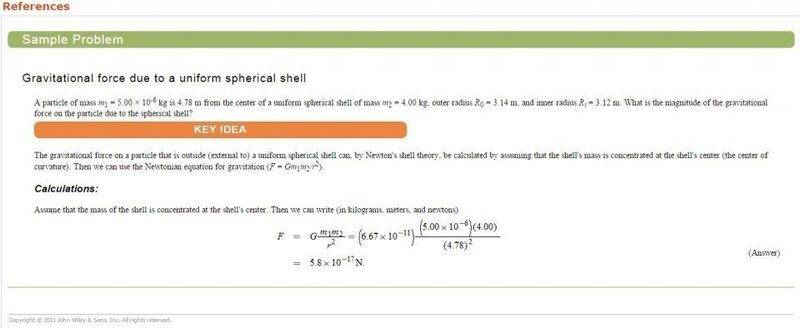

The sample problem linked yields a positive answer.
SadPanda6022 said:
I agree with you there... but I have no clue why..
The sample problem linked yields a positive answer. View attachment 91048
Sure, but that was not asking about a change in force. Try -.328.
Likes SadPanda6022
It took it. So is that typically universal when it comes to gravitational bodies and moving away from them? I mean it makes sense..I move away, I weigh less, so the change in force is always negative as I move away.
