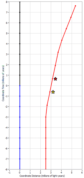

I'm going to draw some spacetime diagrams for you using the Lorentz Transformation process to get from one to the other. In my diagrams, I will assume that the observer at rest with Andromeda is on the Earth and show him as the thick blue line, Andromeda as the thick red line 2.5 million miles away and the observer moving away from Andromeda at 0.4c in a rocket shown as the thick black line. Dots on each of the thick lines represent 1 million year increments of time. I show your event X as a red star exploding at Andromeda and your event Y as a yellow star exploding 1 million years earlier according to Andromeda time. The thin lines represent signals traveling at the speed of light between an observer and Andromeda. I will be showing both how a spacetime diagram depicts simultaneity and how each observer can measure it using radar techniques. In both cases, the key to understanding is Einstein's second postulate, that it takes the same amount of time for a signal to get from an observer to a target as it takes for the signal to get from the target back to the observer, and his first postulate that each observer uses his own clock to measure time and that each observer will measure the round-trip speed of light to be the same value (called c).

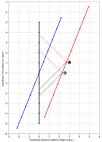

Here's the mutual Earth/Andromeda rest frame showing how the red star exploding at time 0 is simultaneous with the Earth clock being at 0. The yellow star exploded at -1 million years at both Andromeda and at Earth in this Inertial Reference Frame (IRF). You can see the black rocket observer's worldline but we are not yet concerned about his observations or measurements:
To see how the Earth observer uses radar to measure the times, consider the signals that he sent earlier and received later. He has been sending signals continually millions of years earlier but I'm only showing the ones that are significant for our purposes. The one that he sent at his time of -3.5 My (million years) hits the yellow star when it explodes and the return echo arrives at the Earth observer at his time of 1.5 My so he takes the average of those two numbers and gets -1 My as his measurement of the time when the yellow star exploded, the same as his rest frame depicts it. Similarly, he can measure the time of the red star exploding as 0 My according to his clock.

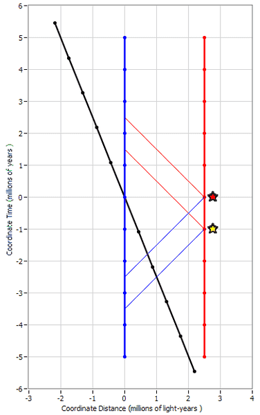

Here's the rest frame of the black rocket observer. Except for the signals, this diagram was derived by taking the coordinates from the first diagram and Lorentz Transforming them at a speed of 0.4c. Note that the event of the yellow star exploding is simultaneous with his time of zero and the red star explodes at his time of about 1.05 million years (My):
Now we can see how he also can make these measurements. He also has been sending out radar signals continually but again, I'm only showing the ones that hit the exploding stars. The one that he sent at his time of -2.25 My hit the exploding yellow star and echoed back to him at his time +2.25 My and the average is 0 My. The radar signal that he sent at -1.6 My gets averaged with the one he received at +3.7 My for a measurement of 1.05 My.
Do you see how this works?
The observers can also measure the distance to the events by taking the difference between the received and sent times, in other words, the interval of time between sending and receiving the radar signals and dividing by two and calculating how far light travels in that amount of time.
Let's see how that works for the black rocket observer. For the yellow star, half of 4.5 My is 2.25 My which corresponds to 2.25 Mly distance, exactly as the diagram depicts. For the red star, half of 5.3 My yields 2.65 Mly distance.

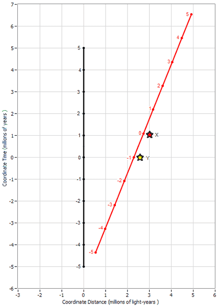

Maybe my diagrams are too complicated or maybe they don't have enough appropriate detail or explanation.
I'll redraw my first two diagrams with an attempt to remedy these problems. Here is the first one showing the observer on Earth in blue and the observer on Andromeda in red 2.5 million miles away with two events labeled X and Y:
I have labeled the dots that represent one-million year increments of time for both observers with the times on their previously synchronized clocks and aligned them with the Coordinate Time of the diagram. They both consider the explosion of the red star, event X, to be in their present because it is at their synchronized time of 0 years. The correct way of saying this is that the events of their clocks being at 0 years and event X have the same Coordinate Time of 0 years. They both consider the explosion of the yellow star, event Y, to be in their past because it is at their synchronized time of -1 million years. The correct way of saying this is that the events of their clocks being at -1 million years and event Y have the same Coordinate Time of -1 million years. I hope I have made this simple enough to clear up any confusion. Does it make perfect sense to you?
Now you originally stated that there was another observer moving away from Andromeda. So here is a diagram showing just that observer in black and the observer on Andromeda in red along with the same two events of the stars exploding:
Since the black observer is moving, he can't synchronize his clock to the Andromeda clock because his own clock is Time Dilated in this diagram meaning that the dots marking the one-million intervals of time are stretched further apart than the Coordinate Time. However, I have set the time on the black clock so that it is at 0 years when the Coordinate Time is 0 years. That means that in this diagram, it is event X that is simultaneous with the moving observer's present. The correct way of saying this is that the event of the moving observer's clock being at 0 years and event X have the same Coordinate Time of 0 years.
Does this diagram and explanation make perfect sense to you? Any questions?

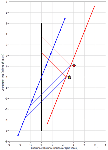

Now to see how the black observer establishes simultaneity according to his own rest frame, we have to use the Lorentz Transformation process to get from the coordinates of the previous diagram to this diagram:
Do you understand how the Lorentz Transformation process works? If not, then, of course this diagram won't make any sense to you.
But assuming that the Lorentz Transformation is not a problem, then we can see how in the black observer's rest frame, it is event Y that is simultaneous with his time of 0 years or in his present. The correct way of saying this is that the event of the black observer's clock being at 0 years and event Y have the same Coordinate Time of 0 years.
So before we can go on, I need to know if everything so far is perfectly understandable to you? Please post any points of confusion.
