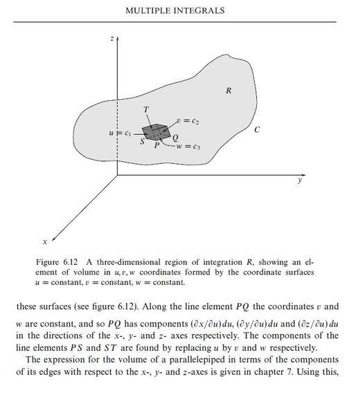

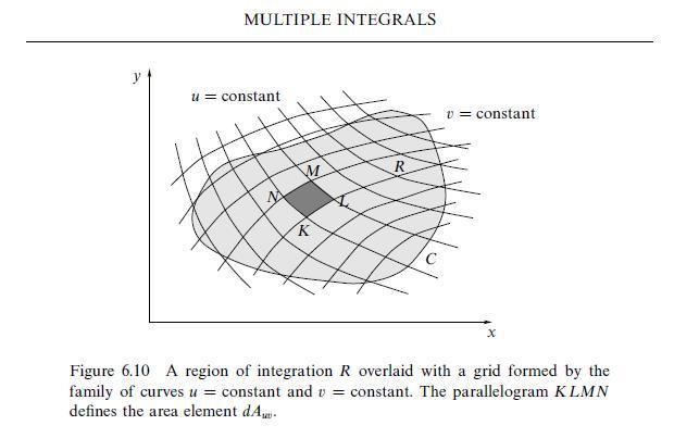

In double integrals, the change of variables is fairly easy to understand. With u = constant and v = constant, along line KL v = constant so dv = 0. Therefore the only contributing variable to ∂x and ∂y is ∂v.
However, in tripple integrals, you're simply adding one more w = constant that gives the 3rd dimension (the height to the initial flat-surfaced parallelogram before).
So as you move along a line PQ (which is formed by say u = constant), then won't BOTH v and w contribute to ∂x, ∂y and ∂z since only u is constant?
  • Figure 6.10: a shaded region R in the xy-plane overlaid with a curvilinear grid of u = constant and v = constant curves, with the parallelogram KLMN highlighted as the area element dA_uv.

  • 3D region of integration R in x, y, z axes with boundary curve C, showing a small curvilinear volume element near point P with labels u = c1, v = c2, w = c3 and corners P, Q, S, T.

In 3D, the object defined by a constant coordinate is a surface, not a line. z = 0 defines a plane, for instance, doesn't it?
They're saying that along PQ two coordinates are constant because that's where two surfaces of (different) constant coordinates intersect.
In short, for 3D:
No coordinates constant: a volume
1 coordinate constant: a plane
2 coordinates constant: a line
All 3 coordinates constant: a point

Hmm I think I got it! For example, u = constant family of curves define the x-y plane, while v = constant define the y-z plane etc... the line is at intersection of the 2 planes where they cut one another.
Therefore, since the line lies on both plane x-y and y-z, v and u must be constant!
Am I right to say that in the new coordinate surfaces u, v and w they need not necessarily be at right angles to one another as in x, y and z?
