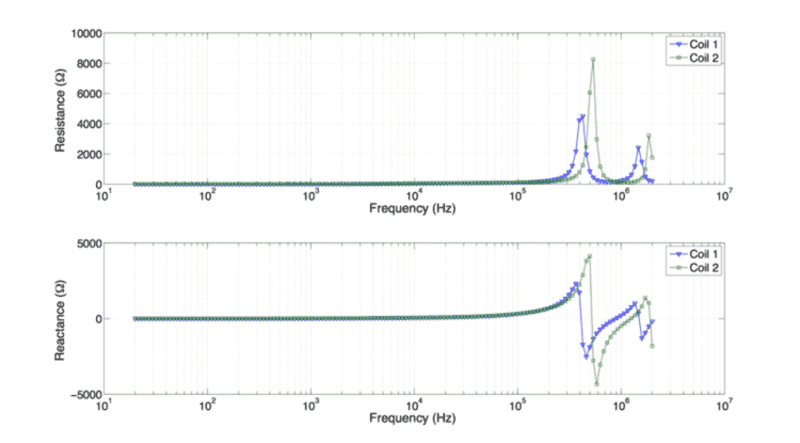

I've noticed something entirely different in my experiments. Here are some resistance and reactance measurements from a couple of coils that I've worked with.
I computed these values by splitting real and imaginary impedance measurements taken on an Agilent e4980A LCR meter.
$$Z=\left|Z\right|e^{j\theta} = R + jX$$
where, ##R = \Re\left\{\left|Z\right|e^{j\theta}\right\}## and ##X = \Im\left\{\left|Z\right|e^{j\theta}\right\}##.
Your last response seemed to imply that if I removed the skin effect from the resistance measurements, the resistance would remain essentially constant over the frequency range. Based on my understanding of the skin effect, I would expect the resistance to increase as frequency increases, but that does not happen here. Do you have any thoughts as to the reason for this? Again, thanks for your help.
It appears that up to 100 kHz things are well behaved.
Where the reactance changes sign there is a resonance.
There are a couple of resonances, one at about 500 kHz and another at 1 MHz.
The very high Q of the resonances shows the resistance is much lower than the reactance at resonance.
It appears the instrument is being dominated by the reactance at resonance.
A series resonant element in series with the DC resistance will look like resistance.
It is being fooled about the resistive component.
That could be because of the multiple turns and cross coupling.
The instrument can only tell the difference between R and jX by the phase of the returned signal.
I suggest that you read the resistance at 100 kHz, then replace the coil with an equivalent resistor. That will tell you if the resonance is in your instrument / leads.
The resistance should steadily rise in proportion to the square root of the frequency.
That is from the skin effect equation.
All other changes to resistance estimates are measurement artefacts.
I wouldn't say that the Q is "very high". The width of the resonance divided by its center freq looks from the plot to be of order 5--well within expected values for a simple coil. BTW, the resonance is caused by capacitance between the turns in parallel with the inductance,
We are in the dark here. We do not know the size of these coils, but I would be very surprised if it was a case of adjacent turn resonance. I would expect the capacitance and inductance of two adjacent turns to be very small and so give a broad resonance at hundreds of MHz, not sharp, at 1MHz. I expect the resonance demonstrated here is due to the capacitance of the terminals and connections to the meter, reacting with the bulk inductance of the coil.

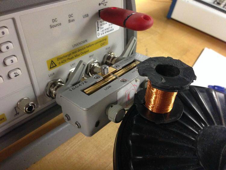

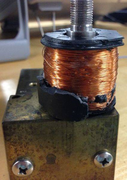

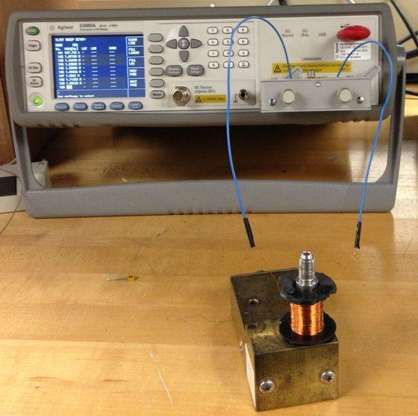

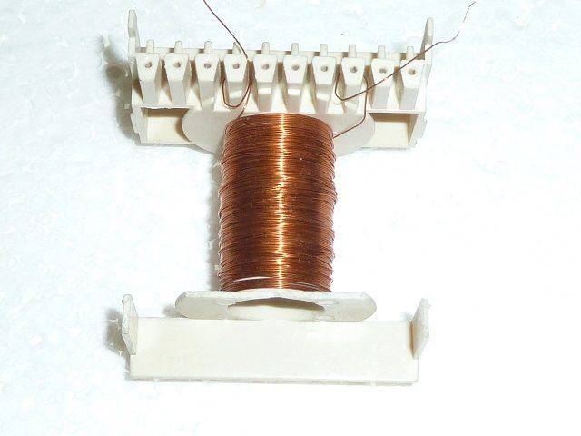

5) Connection to the LCR meter -- see pictures below.
This image only shows the connection with Coil 1, but both were connected in the same manner. The blue wires were soldered onto the ends of the magnet wire and the other ends are attached to the LCR meter via the connection box shown. All measurements were made while the coil was placed on the solenoid valve stem as shown. Thus, there is a (soft) magnetic core inside the solenoid.

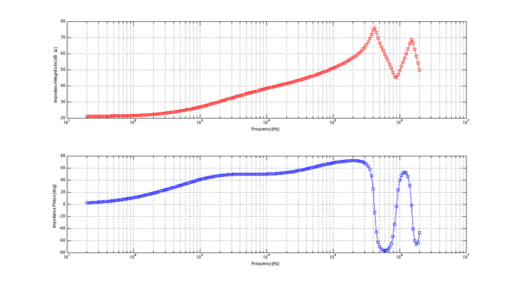

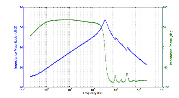

I've seen this resonance behavior before in much larger coils as well. For example, this coil (shown below) produces a similar impedance response.
The impedance Bode plot is shown below. Sorry, the frequency resolution is not as good with this one, as I was first beginning to use the LCR meter. And the magnitude units should read as dBΩ and not just Ω...
The LCR meter outputs ##\left|Z\right|## measured in Ohms and ##\theta## measured in degrees.

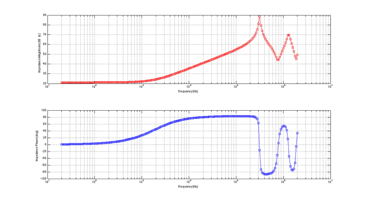

I've made measurements with the coil (only for Coil 1) attached directly to the LCR meter as shown below. The impedance measurements were taken with and without the (softly) magnetic core.
Measurement setup:
Impedance Bode plot with core:
Impedance Bode plot without core:
Thanks again for all the assistance. I really appreciate the input.
Hmmm. at 100khz 50 ohms with core, 55 ohms with no core ?
But at 100 hz, maybe 26 with core, 22 without.
interesting.
In post #11, the "coil 2" picture shows a metal sleeve inside the bobbin. If that is stainless steel it will reduce the inductance very slightly. These coils have a ferromagnetic conductive core while being tested. Above about 10 kHz, skin effect will eliminate almost all of that ferromagnetic material from the inductance computation.

This circuit has a capacitance involved in the resonance that has not yet been positively identified. Where the leads come from the same end of the coil, the capacitance may be “coil end to coil end” capacitance due to the overlaying of the first layer of the coil by the second layer at the common terminal end.
The capacitance involved in the resonance(s) is not in the leads or the instrument; it's the distributed capacitance of the coil itself. There is capacitance from each turn in the coil to ALL the other turns. See here for info:

I wound an inductor similar to the OP's, but with 30 gauge wire rather than 33 gauge. There are a total of 210 turns, roughly in 2 layers:
Then I generated a plot of the impedance and phase angle of the impedance over a frequency range of 20 Hz to 5 MHz. The vertical scale of the phase goes from -100° to 100° and is linear. The vertical scale for the impedance is logarithmic as shown. Phase is yellow and impedance is green:
https://www.physicsforums.com/attachment.php?attachmentid=71586&d=1406181270
There are several self resonances as the sweep approaches 5 MHz; this is typical for a coil of this type.
Here's another sweep, but showing AC resistance in green:
https://www.physicsforums.com/attachment.php?attachmentid=71587&d=1406181270

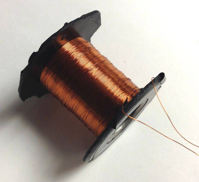

If the coils were close wound as a single layer, then the resonance would be at a higher frequency. An orderly winding would have normal adjacent turn capacitance, but with a significant degree of capacitive isolation between turns at opposite ends of the coil. That is because the turns at the ends of the coil cannot directly “see” each other electrostatically. Only adjacent turns would effect each other as electrostatic capacitors. The resonance would be that of the capacitance of two adjacent turns with the inductance of those two turns alone, but with many of those resonant elements in series.

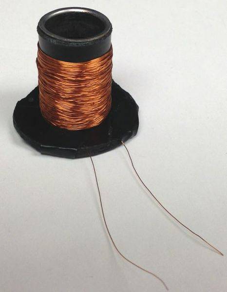

We now see that the coils are scramble wound with no attempt made to keep the ends or layers of the coil apart. The ends of the coil can capacitively influence each other very strongly which will have a completely different self capacitance and resonance behaviour to an orderly close or space wind. It is the two layer wind that has brought the resonant frequency significantly down, by bringing the terminal ends together.
If the coil is for an iron-cored electromagnet, self resonance will matter little, especially when the magnetic circuit is closed. The forgotten art of winding coils with low self-capacitance need not be revived.
The sleeve inside the bobbin is non-conductive. It is used to direct the magnetic field into the stem -- these coils are used to operate a solenoid valve and so directing the field into the stem (where the actuator lies) provides more efficiency.

By length of the coil I meant the solenoid length, not the wire length.
Sorry about that... The length of the coils are: Coil 1 - 1.023 in., Coil 2 - 0.853 in.
What is it made from, iron powder or ferrite? Does it pass all the way through the coil or is it only at the ends?

Here's a sweep of a 1 meter long piece of 30 gauge wire. This image shows the reactance (imaginary part of the impedance) in green and the resistance (real part of the impedance) in yellow. The reactance increases as the frequency increases because it is due to the inductance of the wire. The resistance is another phenomenon due to losses in the copper to the flow of electricity. Those losses occur whether the current is DC or AC. Even though the reactance increases with frequency, one might think the resistance should be constant with frequency, but due to skin effect, it does increase when the frequency gets high enough. We see a slight increase in resistance as the frequency approaches 1 MHz:
https://www.physicsforums.com/attachment.php?attachmentid=71617&d=1406268973
This image shows the magnitude of the impedance and AC resistance. Since impedance is denoted Z = R + jX, with R being the resistance and X the reactance, the magnitude of the impedance is given by SQRT(R^2+X^2); its value can't be less than either component (R or X). Thus, the impedance curve is coincident with the resistance curve at low frequencies, whereas the reactance goes below the resistance curve:
https://www.physicsforums.com/attachment.php?attachmentid=71618&d=1406268973
The next two images show the same two type sweeps but of a 1 meter piece of 10 gauge wire. The skin effect comes into play at a much lower frequency, and the AC resistance of the wire at 1 MHz is about 10 times what it is at 100 Hz:
https://www.physicsforums.com/attachment.php?attachmentid=71619&d=1406268973
https://www.physicsforums.com/attachment.php?attachmentid=71620&d=1406268973
This is an interesting problem because you are winding a coil for an electromagnet, but being distracted by a self resonance. If you put a capacitor across the coil, it would swamp the self resonance. If you drive it with a low impedance switch, that will short out the resonance.
The meter you are using to characterise the coil is effectively not loading the coil, so the meter appears as an open circuit in the analysis. You are then treating the coil of wire as if it is open circuit at both impedance meter connections.
I see two obvious transmission line models for a virtually open-circuit coil.
The first model is that it behaves as a half wave dipole made from the length of the wire, but with a super luminal phase velocity due to the physical length of the solenoid being very short compared with the wire length, with the signal being phase advanced by the inductive coupling.
The second model would be that you have built a transmission line shorted at the far end. You are really analysing a transmission line half the length of the wire. Again there will be a super luminal phase advance due to the inductive feed forward.
I have no idea how to calculate the over unity velocity factor of a scramble wound coil over a cylindrical metal core. My guess would be somewhere between 1 and 25.
Both those models would explain the resonances you are seeing. Maybe you are seeing both?
But I get back to the point that you are making an electromagnet coil that will be driven by a low impedance switch. The driver will short-circuit any open-circuit self-resonance effects. So why follow what is an irrelevant distraction?
If we take the wire length of coil 1 to be = 63.9m, as computed from the resistance.
That will be half a wavelength at a frequency of 3x108 / (2 * 63.9) = 2.35 MHz.
The first resonance of coil 1 appears at about 400 kHz.
This gives a phase velocity factor within the coil of 2.35 / 0.4 = 5.875
I am reasonably happy with that analysis.
You will need to change the length of the wire in the coil to test the half-wave dipole model.
CopyOfA, what is your purpose in all this? Are you trying to replace the coil shown in picture 4 of post #11? If so, why do you need to need to know about impedances? In that case why not just wind a new coil as similar as possible to the old one?

Hey everyone, thanks for all the responses and input. I must apologize for not responding sooner; I was on vacation with the fam. Anyway, my purpose is to understand how the coil behavior evolves as the wire insulation ages due to temperature, humidity, or electrical stresses.
Baluncore said:
inter-turn capacitance is not the direct source of the self-resonance observed, nor is the metal core. It is the length of wire in the helical coil.
So, are you are suggesting that if the equivalent length of wire were wound into a single-layer coil, we would see the same impedance response as that of the same length of wire wound into a multiple-layer coil? I'm confused by the apparent conflict between your response and this paper: http://ieeexplore.ieee.org/stamp/stamp.jsp?tp=&arnumber=602562&tag=1.
Unfortunately, the paper you referenced is behind a paywall.
The electrical behaviour of a roll of wire will depend on how it is connected to an external circuit. When operated as an electromagnet, a coil can be modeled as inductance, series resistance with a small lump of parallel capacitance.
When open circuit, a coil will have the characteristics of a self resonant dipole. That is because it is then best modeled as a Transmission Line. A TL is modeled as a large number of small inductors with many capacitors to ground. That is, a long, high order, low pass-filter. The impedance of the line and it's velocity factor come from the value of those short L and small C elements. But your line is not being driven in a mode relative to ground. You are driving it relative to some average environment from both ends, differentially. The coupling between meter and the coil is very weak, so the coil can demonstrate it's dipole character of Self Resonance. SR Frequency is a distraction because it is a coil construction artefact, seen only when open circuit.
You would expect the phase velocity of a TL to be subluminal, but here the line is coiled and closely coupled. That coupling inductively feeds signal energy forward and so can speed up the propagation along the wire to become superluminal.
The voltage difference between adjacent turns is very small, so the capacitance to other higher voltage difference turns further along the wire, or with the environment, sets the velocity factor, SRF and Q. That is important because the coil is scramble wound back over itself, with the two ends close together.
Any small change to the structure of the coil will make a difference to the self resonant frequency. Scramble wound coils will exhibit a strong SRF if wound neatly. But if the coil is wound as a number of separate pies, say 3 layers over 1/3 of the bobbin at one end, with 1 layers at the other end, then each element will have it's own SRF, they will be in series, so the SRF peaks will not be so strong.
Google images 'pi wound rf choke' for an idea of how coils are wound to trade off minimum self resonance against an increase in resistance.
As has been said several times earlier, self resonance is a distraction. You need ampere turns for an electromagnet. That requires a low impedance driver which will kill the SRF you have been observing.
Sorry... I've attached the paper to which I was referring.
Baluncore said:
SR Frequency is a distraction because it is a coil construction artifact, seen only when open circuit.
I don't understand why this coil is operated as an open circuit when measured by the LCR meter. A resonant frequency seems to coincide with your description of the coil being operated as an electromagnet, right? A Parallel(Series(L,R), C) circuit?
But, I've shown a plot (see below) where the two ends of the coil were not (relatively) close and still the self-resonant behavior was seen. Also in this plot are two more resonant peaks (or three if you count the very small peak at a little less than 2e5Hz).
I hope I'm not insulting your intelligence... I'm just having a hard time understanding whether the measurements I'm making are valid and useful for analysis or simply erroneous.
Your measurements are real and valid. They are not erroneous.
The distraction is that, they are not relevant to your application.
If you use the coil as an electromagnet, the dipole resonance will be an irrelevant ghost.
Thanks for the text, I will read it and see if I can understand the modes they are considering. At first sight it appears the “stray” capacitance they are considering completely ignores the intermediate inductance between turn capacitance. That denies the existence of the implicit LC transmission line.
The self capacitance of a coil does not come as a single lump. The values presented cannot differentiate between their LC lump analysis and a TL model. Indeed, the –17.2% and +9.68% prediction errors they report immediately before their conclusion might be considered to suggest that their lumpy model is not applicable. It may be due to a near coincidence of the models.
The coil will be used as an electromagnet with a solenoid valve. However, I would like to make these measurements as the coil is being used. I'm curious what you think the measurements would look like as the coil is being used as an electromagnet.
I'm still confused about the reasoning behind the idea that the coil is being measured as an open circuit. Isn't the meter applying a voltage signal across the coil ends (and the meter is grounded)? Doesn't this impedance measurement completely describe the electrical characteristics of the coil?
Also, the measured impedance response of the coils can be (approximately) fit by a parallel(series(L,R),C) circuit model. This is the same model that was suggested for the coil operating as an electromagnet. Why is this not applicable to the coil as it is being measured with the LCR meter?
