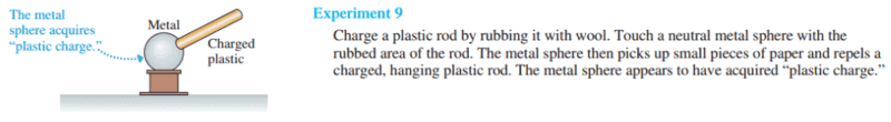

Textbook illustration of a neutral metal sphere on an insulating stand, with a charged plastic rod touching its surface and the label "The metal sphere acquires plastic charge." Beside it is Experiment 9 text describing rubbing a plastic rod with wool and touching a metal sphere.
Ques : If a neutral metal sphere placed on an insulating stand is touched by a charged plastic rod , does the metal sphere acquire any charge ?
I think that by simply touching the sphere by insulating rod , the metal should not acquire any charge as the charges on the rod are immobile unlike a conductor .
But if the rod is rubbed against the metal sphere , then by friction sphere might acquire charge .
So , is the above text correct when it states that the metal sphere acquires a net charge on being touched by charged plastic rod ?

  • Textbook diagram of a metal sphere on an insulating stand, with a charged plastic rod touching it, labelled "The metal sphere acquires 'plastic charge'"; beside it is the text of Experiment 9 describing rubbing a plastic rod with wool and touching a neutral metal sphere.

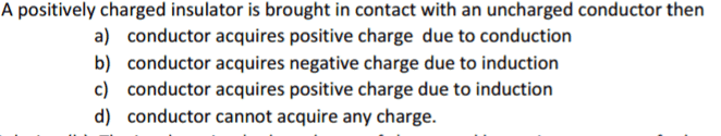

  • Multiple-choice physics question: A positively charged insulator is brought in contact with an uncharged conductor, then options a) conductor acquires positive charge due to conduction, b) negative charge due to induction, c) positive charge due to induction, d) conductor cannot acquire any charge.
@Daniel Sellers , I see you have edited post 13 and posted a video showing charging by conduction . The text in the video states "Electrons transfer when conductors touching each other " . Are you sure the rod in the person's hand is an insulator ?
Hmm that is confusing. I assumed it was a conductor because, A) it appears to be plastic and more definitively B) he is holding an object in his hand which he uses to charge the electroscope by conduction, which would discharge the rod if it were a conductor. Perhaps part of the rod is a handle and the other end is a conductor? It appears to be a homogenous material. There is also this video.
Although she does do at least a minimal amount of rubbing in order to charge the electroscope. Other videos explain with diagrams the same concept; charging the electroscope by touching it with a charged insulator.
It's certainly possible I'm mistaken (and misremembering my class?) and, practically speaking, a simple touch of very limited area is not sufficient to conduct a significant charge to a conductor, but I'm not convinced that's the case. This second video demonstrates that, at least theoretically, some charge is transferred from the insulator to conductor.
Edited "...touching it with a charged conductor" to "...with a charged insulator" above. Whoops, typos.

Answer: Yes, both in theory and in practice.
Assuming that this is at the level of first year undergraduate intro physics, then I will quote from Randall Knight text "Physics for Scientists and Engineers", 3rd Edition, Pg. 727 when he discussed charged insulating rod:
