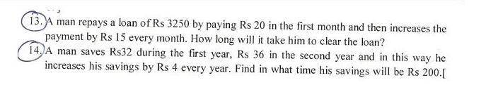

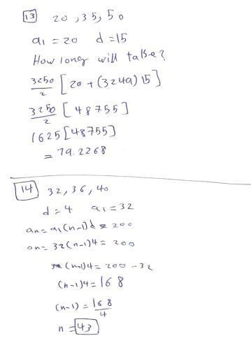

Hi all
I try to solve and i want checkmy answer

I don't think your answers make any sense at all.
For #13 you state 79.23. Well, 79.23 months? days? years? seconds? Doing the calculation myself tells me that you've done something wrong here.
For #14 you say 43 years?? If he saves 32Rs/year for 43 years he would save well over 200Rs and that's not accounting for the +4 Rs/year.
Setup some simple formula describing what they are doing.
For example, if you want to find the number of years it takes to save 200Rs given all the information in the problem, you could setup something like:
[tex] 32 + (32 + 4) + (32 + 4 + 4) + ... + (32 + 4N) = \sum_{n=0}^N (32 + 4n) = 200[/tex]
and solve for N.
