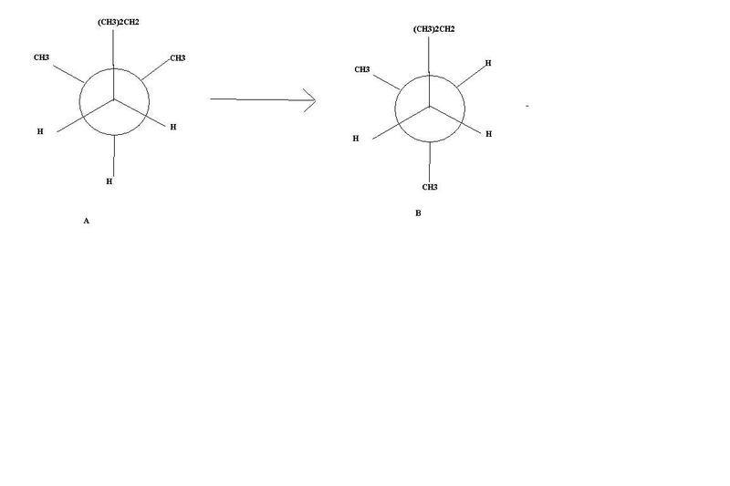

there is absolutely no difference between the two structures I have drawn. You are labeling carbons (A and B I assume) and calling them "Cis" and "trans" when carbons A B C are all the same.
Looking at the newman projection of the c2-c3 carbons you can see that there are only two configurations that are likely to exist, which I have drawn. It is possible for the methyls to line up directly with the isopropyl on the front carbon, but this is very energenically unstable. These aren't isomers, however. They are all the same molecule, the newman projection just shows you a snapshot of the c2-c3 carbons while they rotate at an instant in time.

Thanks for the diagrams.
In my previous post I was trying to say that the two configurations which you have clearly drawn in picture 1 are both trans (wrt third carbon as centre). Is this a correct way of stating it? Or have I misused the language because whenever there is a trans there must also be a cis (otherwise don't use cis, trans lanaguage)? In this case there is no cis so I shouldn't be using the word trans?
