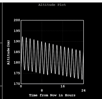

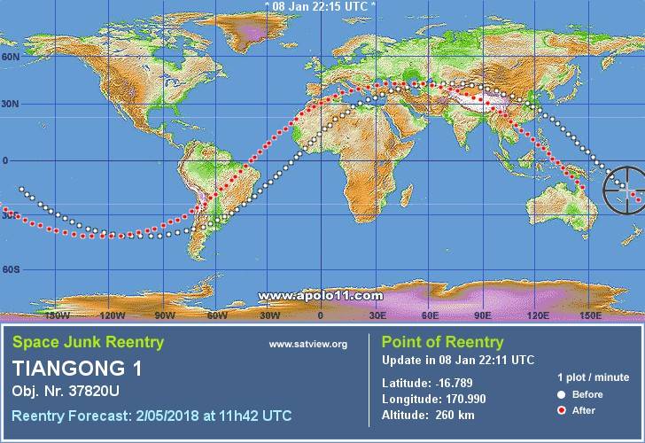

Today (Jan. 8, 2018), China said in the newspaper that they have all satellites under control. In fact, China has been getting these objects from the obit to the Gobi desert as calculated and China has plenty of experience about where to have the orbiting body to be falling. Having the rover soft-landed on the moon surface at the precise location already, and planning to do the same in the far side of the moon, there is no issue for China to control the Earth orbit body. China has the world fastest supercomputer that must be helping to do all space program.
I was thinking that they were mean, not having it fly over UK. Now, I'm not so sure. :wink:
Likes CalcNerd and berkeman
Likes OmCheeto, Spinnor and stefan r
Tiangong1 did not go to the moon. It does not matter how much computer you have. When you lose communication you lose control.

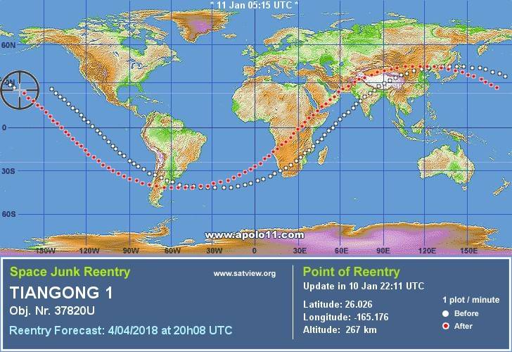

Laurie K said:
Good job catching that snapshot image of the re-entry date: May 2nd
Today, two days later, the date has been changed by a month: April 4th
Physics Forums copies the
file and stores it as a local attachment but other sites keep the external link so refreshing the page updates the forecast image. The reentry dates now seem to range between April and May.
The prediction will become much more accurate closer to the actual deorbit date - predicting the density of the upper atmosphere months in advance is not really reliable.

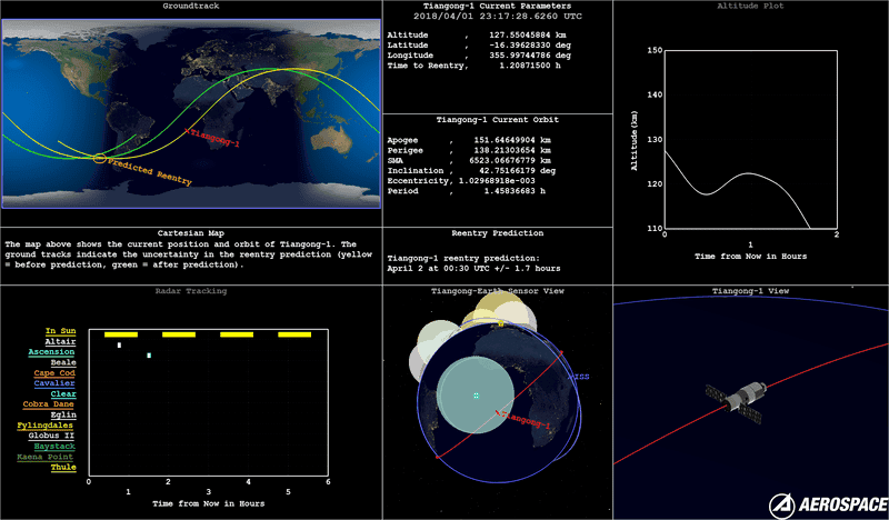

This looks neat,
From, http://www.aerospace.org/cords/reentry-predictions/tiangong-1-reentry/
Looks like it is predicted to skip a bit?

  • #42
If you are referring to the dip then rise in altitude, that's actually because it's in a slightly elliptical orbit.
Here's a snapshot I took a couple of days ago:
2018.03.30 0019 PDT
Likes Spinnor
