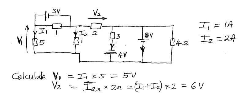

Hello, I have tried really hard to understand this circuit but I just can't grasp it.
I am trying to understand how V2 comes to 6 volts ie. where does the 3amp come from that is multiplied by the value of V2 to give 6 volts.
It would help a lot if I could see the linear equation which gives 3 amps for the relevant loop.
Thanks kindly for any help with this.

hello fran1942! :smile:
use KCL to find the current through the bottom wire, directly under the 2Ω …
how much is that, and how does it help you to find the current through the 2Ω itself? :wink:
OK thanks. I see that current will be the combination of the 2 and the 1, making 3. Is it as simple as that ?
The main thing bugging me was that I could not work out the linear equation to give that 3amps.
Could someone please help with that equation.
Thanks again.
fran1942 said:
… I could not work out the linear equation to give that 3amps.
not following you …
the KCL linear equation for that junction under I2 is 1 + 2 = 3 …
what is worrying you about that? :confused:
