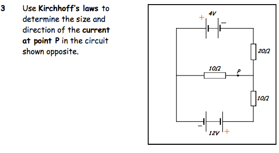

Circuit question: Find size and direction of current at P

Let I1 = I2 + I3 where I1 is the current on the top wire, I2 the current on the middle wire and I3 the current on the bottom wire.
4 = 10I2 + 20I1
//This is what I started trying but I can kind of tell that this is wrong

If you assume I1 to be clockwise and I2 to be from right to left, this equation is correct. Assume a direction for I3 and write another equation. Your directions may be wrong, but that will just give you a negative value for the current.

If 4 = 20I1 + 10I2 is correct then 12 = 10I3 + 10I2 is correct
I1 = I2 + I3
4 = 20(I2 + I3) + 10I2
4 = 20I3 + 30I2
12 = 10I3 + 10I2 can be made into 24 = 20I3 + 20I2
Using simultaneous equations: 20 = -10I2
I2 = -2
But is this correct?

dw I figured out where I was going wrong
