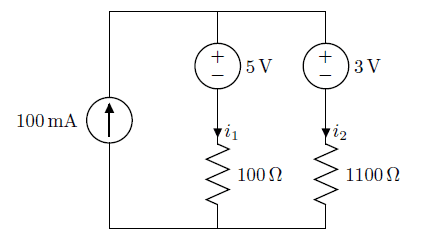

Circuit with 2 voltage sources and 1 current source
3 replies · 3K views · last reply
ichabodgrant
48
Circuit schematic with a 100 mA current source on the left, and two branches in parallel: a 5 V voltage source in series with a 100 Ω resistor carrying current i1, and a 3 V voltage source in series with a 1100 Ω resistor carrying current i2.
Here is the circuit. I have to find the voltage across each resistor and the current i1 and i2.
My attempts are the following:
By KCL,
i2 + i1 = 0.1 A
By KVL,
3 - 5 - 100i1 + 1100i2 = 0
∴ i1 = 0.09 A, i2 = 0.01A
∴ Voltage across 100Ω resistor = 0.09 × 100 = 9 V, voltage across 1100Ω resistor = 0.01 × 1100 = 11 V
Are there any mistakes?
