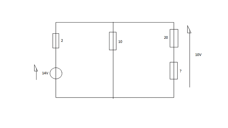

The circuit has an unknown component that is a resistor or a voltage source, find which one it is and it's value.
V=IR, KVL, KCL
I first used KVL on the outer loop:
14-2I1-10=0
I1=2A
Then on the inner left loop
14-4V-10I2=0
I2=1A
Then KCL to find current through 20ohm resistor of 1A
Inner loop on right hand side
10I2-1x20-?+0
? =-10V
Answer:
Due to the direction of the current the -10v couldn't be from a resistor as it would result in a positive 10v over the resistor.Instead it must be a -10v source.
Does this look correct? If this was a -10v source wouldn't that disprove all the currents I found?
Thanks
Circuit schematic with a 14V source and 2 ohm resistor on the left branch, a 10 ohm resistor in the middle branch, and a 20 ohm resistor and an unlabeled component marked ? on the right branch, with a 10V arrow on the right.
Your analysis looks fine. The currents would be fine, too, when the mystery component is a -10V source.
Thank you, so if I understand this correctly, because we knew the 10v across the mystery component and 20ohm resistor this allowed the correct currents to be calculated.Once we knew these currents we could disprove the mystery element being a resistor?
Yes, that is so.
