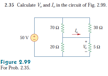

[Circuits] Calculating voltage and current in a circuit

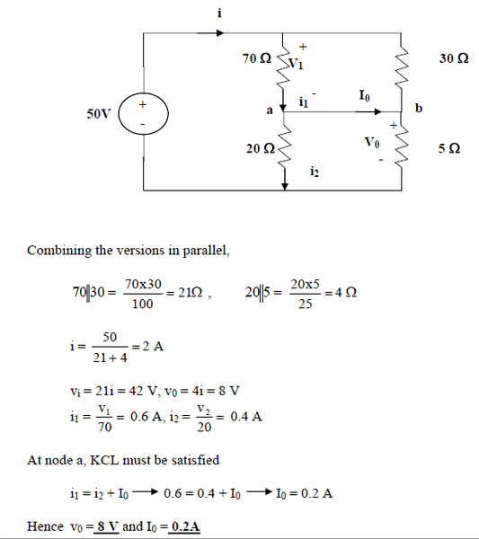

How does the author do the below?
$$v_{ i }=2li=42V$$
What equation is he/she using?
That should be 21i. 21 Ω is the parallel combination of the 70 Ω and 30 Ω resistors. The author is calculating the voltage drop across that pair.
They seemed to have applied KCL at the middle node: $$i_1=i_2+I_0$$
But what about the other side of the same node? It looks like they only looked at the left-side of that node. Is that acceptable?
The current Io takes care of whatever is happening on the other side; the node was partitioned in order to "get at" the current Io . If you want, think of the horizontal wire as a zero ohm resistor separating two nodes :smile:
