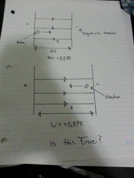

if w = - change in epe
why does power = +epe / time if power is supposed to equal w / t shouldn't it be equal to -EPE / time
Please help me clarify this.
epe= electric potential energy
and also if current equals to Q/t
is there a negative current if there is a negative charge? isn't current supposed to only go from positive to negative terminal

It can be. The sign of the work is an arbitrary convention.

this still doesn't really make sense to me, so your saying that you do not need to add the negative sign in front of epe?
No - I am saying that what sort of work counts as positive and what negative is a matter of definition.
Basically - if something loses energy, then it has done work, and if it gains it, then it has work done on it.
Which is positive and which negative depends on what you want to pay attention to.
You may be quite happy to say that work is negative when the thing loses energy, i.e. it does work - but we measure a car engine power as positive don't we(?), even though the engine is the thing doing the work?

so I did some reading and i found a passage in my textbook
"W=–ΔPE. For example, work W done to accelerate a positive charge from rest is positive and results from a loss in PE, or a negative ΔPE. There must be a minus sign in front of ΔPE to make W positive. PE can be found at any point by taking one point as a reference and calculating the work needed to move a charge to the other point." which makes sense.
so if i apply this principle to a proton that is losing potential, i get a negative power. is it possible for a + terminal to have a initial voltage of zero? sorry if this is really basic I am doing a intro physics course and i never taken it in high school and this electricity stuff is very hard to conceptualize.
edit final voltage = x > 0 lol.
and also what does it mean when we have negative power in electricity?

hmm, so if a positive charge is moving towards the negative terminal with the electric field it would mean that it is losing PE therefore work = - EPE, and if a negative charge is moving against the electric field towards the positive terminal it would gain potential energy? therefore W = + Delta EPE
can someone confirm if this concept is right and i should use it for life.

From what I can see if this thread, and the diagram in particular, no one has specified point charges. The issue was to do with work done and potential change.
so would this be a correct assumption.
Which way is the force, due to the charge in the field, in each case? To move it 'with' the force involves negative work. To move it 'against' the force involves positive work.
Apply that rule to those pictures. Which ones are correct and which are not, according to the above rule?

Both of them are correct right?
but if we say the ΔV = +2500v for both the pictures and use concervation of energy
we would get
KEo + PEo = KEf + PEf
0 + qVo = ½mv2 + qVf
-qΔV = ½mv2
and if you solve for velocity
V = √-(2(q)(2500V)/M))
which would not work for a positive charge but would for a negative
so I am kind of unsure of these rules.

Ask yourself is this consistent with the idea that when the charge moves against the attractive force you do positive work on it and when it moves with the force you do negative work. If you stick to that way of viewing it, can you go wrong?

The potential energy decreases in both cases so the KE is positive in both cases. It does not matter what is the sign of the charge. The field is accelerating the charge in both cases. For electron the potential energy decreases when it goes against the field lines. So the work is positive and the KE increases.
The work (done by the field) is the negative of change in potential energy by definition. Your second drawing has the sign wrong.

His drawing shows just a charge in uniform field. No wire, no generator, just the field and the charge. I was referring to that drawing and nothing else.
That charge gains KE in both cases, so this shows that the work is positive in both cases.

Hang on.When Energy comes out of it, the potential change is Negative as negative work is done on the charge. Energy is conserved and KE (with a v squared in it) is always positive, so the PE change must be Negative when a charge moved under attraction. That is how potential is defined by convention. The + terminal of a 6V battery means that it takes +5 Joules to take a Coulomb of positive charge from the Negative terminal to the positive terminal.
There is too much in the way of personal hand waving and 'description' in this thread and not enough emphasis on the 'rules' that the conventions give you.
All of those pictures show situations where a charge is 'pulled' in a particular direction by the Volts on the plates. They all involve negative potential change.
It is only when you put Work into the system (with a string or a rod, for instance) that you can do work On the system and increase the Potential Energy in it by moving the charge by some external agent.

Four cases? I am afraid there is some confusion still. There were only two situations described there and in both cases the charge is accelerated by the field. Nothing in the blue sentence is against any definition of potential. The potential is not even mentioned in the sentence. The sentence only describes what the diagram shows and indeed the charge is accelerated by the field.
I was referring to this
41208_230339-jpg.76422/
where the poster asks if he is right when he write that in the second case the potential energy increases.
How can you say that the sentence "The field is accelerating the charge in both cases" is not appropriate for what is shown in the diagram? And how is this simpel statement of facts is related to definition of potential energy or any convention of signs or anything?
I still feel like you are talking to someone else or attributing me what I never said.
I have no idea why do you think I somehow got the potential and potential energy wrong or that I defined as the "work done by the mass", whatever that means. In my post I just mentioned work done by the field.
Can you tell me what sentence in my first post you don't agree or you consider against any definition? It's a very short post, it should be easy to do it. Here it is, for convenience:The potential energy decreases in both cases so the KE is positive in both cases. It does not matter what is the sign of the charge. The field is accelerating the charge in both cases. For electron the potential energy decreases when it goes against the field lines. So the work is positive and the KE increases.
Some confusion in that there are two pictures - but they are identical? I looked at one then, later, I looked at the other and they both had an error.
But no confusion about any case where the charge is being accelerated by the action of a Field. How can it possibly be increasing its potential energy if it is 'falling downhill'? We are discussing a conservative system and if no energy is being supplied by an outside agent, the total Energy is constant. That is my problem, as I could see no sign of Work being put into the system.
I don't think I was having a go at you aamof, unless you were saying he is correct, that is- in which case I was.
But, whoever and whatever, there has been confusion about what constitutes an increase in potential energy and it surely should't have taken us 29 posts to straighten it our. Just the Fog of War, I guess.
But who said that the potential energy is increased? The point of my post was to say exactly this: that in the second drawing the conclusion that the PE increases is wrong. You are attributing me exactly the contrary of what I was saying.
"Your second drawing has the sign wrong",see that?
And "The potential energy decrease in both cases". These are thing I said. What you are attributing me I did not.
