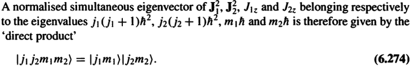

Printed text equation (6.274): a normalised simultaneous eigenvector of J1², J2², J1z and J2z is the direct product |j1 j2 m1 m2> = |j1 m1>|j2 m2>, with eigenvalues j1(j1+1)ħ² and j2(j2+1)ħ².
From (6.274), isn't it true that
##|j_1j_2m_1m_2>\,=|j_1m_1>|j_2m_2>\,=|j_2m_2>|j_1m_1>\,=|j_2j_1m_2m_1>##?
And hence
##<j_1j_2m_1m_2|=\,<j_2j_1m_2m_1|##?
And so ##<j_1j_2m_1m_2|jm>## and ##<j_2j_1m_2m_1|jm>## should always have the same sign.

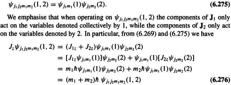

Why does the order in the direct product matter?
Printed textbook page with equations 6.275 and 6.276: product state psi of j1 j2 m1 m2 as psi j1 m1 times psi j2 m2, and the J_z eigenvalue derivation giving (m1 + m2) hbar.
From (6.276),
##J_z \psi_{j_2 j_1 m_2 m_1}=(m_1+m_2)\hbar\psi_{j_2 j_1 m_2 m_1}##
It seems like the order doesn't matter. Could you give an example where the negative sign is necessary when the order is flipped around?
