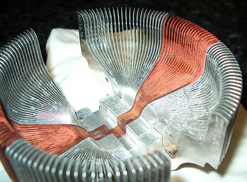

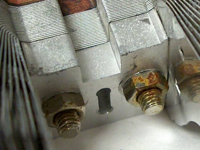

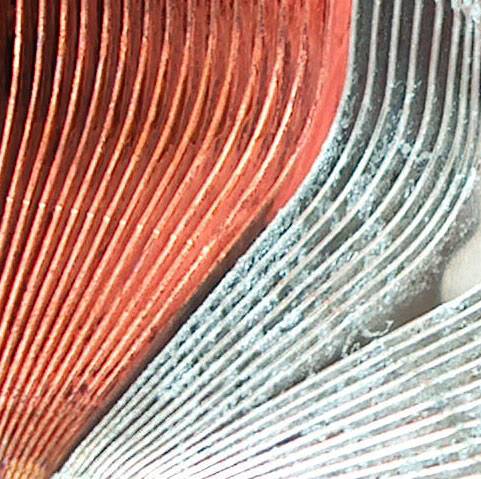

Here are some pictures of my particular heatsink:
Fan removed.
Rust on the bolts that hold the fins together.
Bleh.
As you can see, the copper is in contact with the aluminium. I don't know how difficult it would be to remove the bolts and take it apart. This would also create an uneven base, as the fins wouldn't line up exactly as they where before. I would have to lap the base after reassembly. This is why I want a method of coating the aluminium and copper at the same time.
Typical operating temperatures are between 20'C and 55'C, relatively low I would guess. I live near the coast, so there's more salt in the air than usual. Also the humidty is quiet high. I live in Durban, South Africa.

From those pictures.
I'm thinking you might want to invest in a dehumidifier.
I doesn't seem likely that the computer is the only thing that is having problems with all that water.

Looking at the pictures, I would suggest removing the bolts, putting the aluminum piece in a mild NaOH dip for the right amount of time, then anodizing the aluminum and putting the pieces back together. The last step does not appear to me to be as difficult as you think it is. You only have to machine a little T-shaped section out of something else to use to realign the pieces.
Also, what are the fasteners made of? If they are regular steel or zinc-coated steel bolts, I would consider replacing them with stainless steel bolts (or even with aluminum bolts) and nuts.
The cause of the corrosion appears to be the contact between Cu and Al. Coating all but for the mating surfaces, will do little to protect your heatsink from subsequent corrosion. Only, you might not know it's corroding under the coating.

I'm guessing coated steel bolts as well as a coupling between Al and Cu. It looks like some rusting on the bolts.

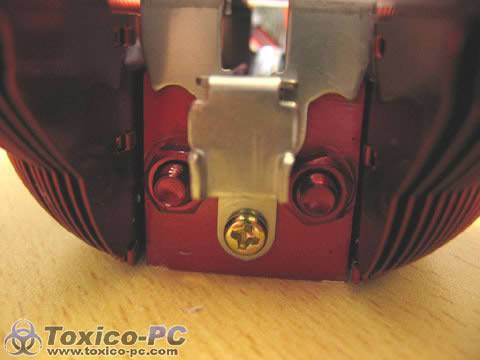

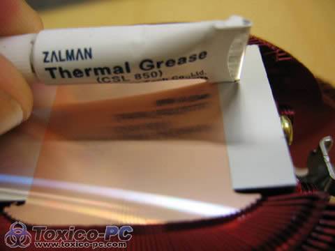

This is another zalman cooler:
http://www.zalman.co.kr/eng/product/view.asp?idx=174&code=009"
How is this thing coated? It's all copper.
It's a sandwich of 70 copper sheets, rather than a 24 sheet Cu sandwich between two 23 sheet Al sandwiches --- what coating? You want to plate it? Same problem as the Al-Cu-Al --- wicking of plating solutions between the sheets. Less bimetal problem, if there was one (doubt it), and no Al doing what Al does when in contact with salt air (corrode).
It's been coated with something to make it red. Most reviews that comment on the colour say it's been anodized, but copper can't be anodized, so what is it?
Cu is a "red" metal. Cu can be anodized --- it isn't a tightly bound film as on Al, and isn't all that useful a process for anything. It's conceivable that you're looking at OFHC Cu --- "oxygen free, high conductivity" copper --- again, a "gilding of the lily" for heat sinks. Grab yourself a piece of heavy gauge copper wire, or scrap copper tube and play around a bit with a Bernzomatic, or whatever you can lay hands on for propane or butane torches --- oxidizing and reducing zones of the flame --- and with water and oil quenches of a piece heated to "red heat" at one end (use pliers --- it is a good heat conductor) --- you'll notice a gradation of color on the surface, red (black body emission red) through gray, black occasionally, and some almost bright reds (not red heat) as various oxides form, and decompose --- you'll see the color zones move as the temperature gradient develops toward steady state.
mmm...definitely coated with something looking at these pictures...
You can see the base is the usual copper colour, but the fins are deep red.
