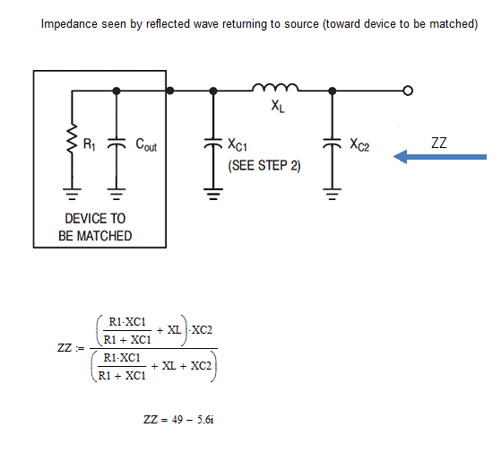

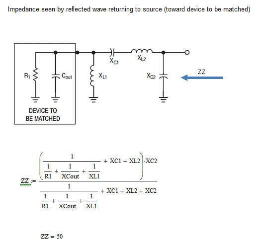

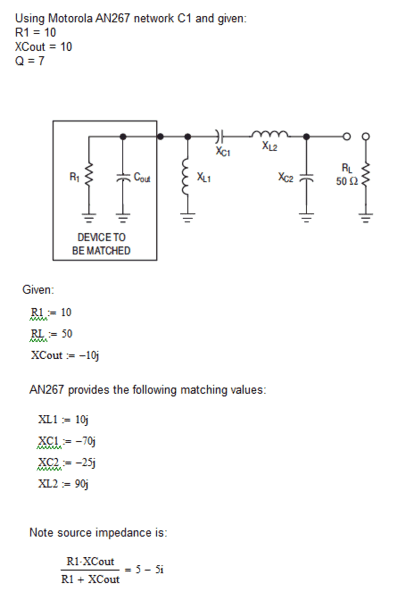

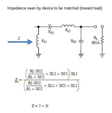

Agreed, I would like to digest these but it will take me some time. There does seem to be a divergence of opinion on this interesting topic (or maybe I am just not up to speed).
In the meanwhile here is what I have done:
I used Motorola AN267 which was created to help impedance match RF power amplifiers to transmission line. I designed two cases:
Case1: 1 ohm source impedance to 50 ohm line.
Case2: 5+5j source impedance (10 ohms parallel with 10j capacitive reactance) to 50 ohm line.
The results are attached (clipped from Mathcad).
Images 1,2,3 are case1.
Images 4,5,6 are case2.
Note that in both cases the network presents the desired impedance to the output of the amp while simultaneously presenting 50 ohms to any signal traveling in the reverse direction from far end reflection.
I would say that this is a "first order" method of matching. More elaborate schemes are used that take into account non-linearities and load pull characterization, but it seems that the basic scheme provides backmatch.

@the_emi_guy
The calculations are probably right; you can clearly drive the software correctly and your network will present the 50 Ohm load to the transmitter as a 1 Ohm load and vice versa. That would be a match for maximum power. It would result in an equal amount of power being dissipated in the 1 Ohm source resistance. No problem for a low power amplifier and it would be a well behaved piece of equipment - like a good Test Signal Generator, for instance but, with 50% efficiency, a high power transmitter would produce loads of embarrassing heat in its output stage and cost a lot of money to run. That was the point I have been making. I have never claimed that you can't match power amplifiers to deliver maximum power but I know that high power transmitters are built to be efficient (90% or so) and so they cannot be matched in that way - else, where do they get the 40% lost power back from and why do they not melt into the ground? Would you comment on that issue please and not on the nuts and bolts of matching networks?

sophiecentaur said:
@the_emi_guy
I hear you sophie, I understand your point and I need to think about this some more...
