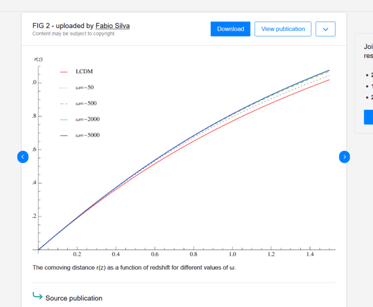

Hello,
here is one of many similar examples for the increasing comoving distance D with the redshift z.
I have now an idea what you are meaning and in which sense D has to be assigned to z.
The comoving distance to a given galaxy never changes, even though the redshift we observe in light from that galaxy might change. (Which does not mean it will necessarily increase in the future.)
The comoving distance to different galaxies with different redshifts is of course different. The relationship between comoving distance and redshift can change with time.
I think you are failing to distinguish these different things and it is confusing you.
Please give a link to the source. The graph by itself is not enough.
