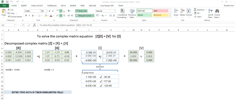

I have a circuit that I am to analyse and find I. I am told to use an excel matrix sheet given to me to solve 3 unknowns. I have 4 loops so this is a problem. I have made an attempt using three loops and referred to a previous thread on here for some help. It says I can do it with three loops.

I have attempted the question many times and am including my results. They do not seem to agree with the results for the agreed answer on here.
Loop 1 --- 120-(2)I1-(I1-I2)(-j5)=0
Loop2 --- (-j5)(I2-I1)+(j4)(I2-I3)-14.14+j14.14=0
Loop3 --- (j4)(I3-I2)+(4)I3-j120=0

I am incuding this and a spead sheet I am using. any pointers would be amazing as I am completely lost wheln I use the spreadsheet.[/B]
here is the pic of the spread sheet
Are you confident about the sign of the voltage terms in loops 2 and 3? Read through the related conversation with the OP in the thread you referenced: he had the same issue!

thanks again for help. I have changed my answers but they still won't work in spread sheet

As far as I can tell with a quick glance, your recent attemp2.pdf shows correct loop equations. Good!
Regarding the spreadsheet's inability to solve the equations, take a look at the conversation that occurred in the thread that you referenced previously, starting around post #98 :wink:

I'm trying to follow along. I put a 0.001 in the center cell of the Real matrix, as the warning suggested. This allows the spreadsheet to calculate values.
I put the same matrix into Matlab and solved the system and arrive at the same answers as the spreadsheet.
As far as I can tell, your loops and matrices look correct. Are the answers in the original post the "correct" answers that you are supposed to arrive at?
I have done this question and can tell you that I couldn't get the thing to work at all with some zero values. As scottdave above says, you need to put in a very small number just to allow it to compute.

I have obtained the correct answers by entering 0.0001 in the spreadsheet. Thanks for help though. I always thought it would be me wrong and not the spreadsheet
