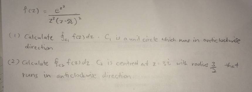

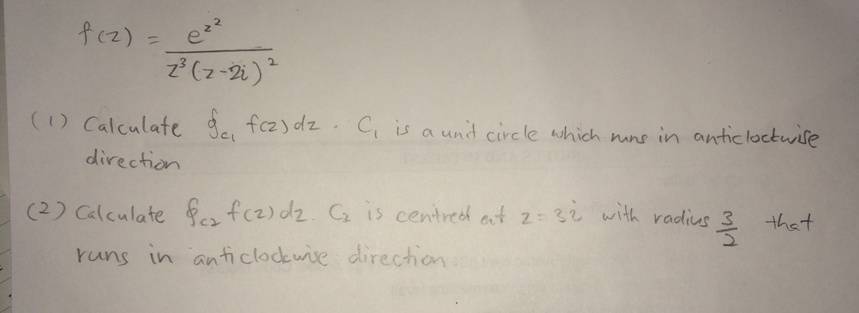

Hello.
I am not confident about this question. I think I have to use cauchy integral formula. But before that, I should decompose the fraction, right? Or is there a simpler way to do it? A friend told me that each contour only had one pole interior to it so he just used the Cauchy integral formula for the appropriate derivatives--as opposed to using a residue calculus. Is this a correct method?

Very well!... I suppose that also in this case the residue theorem is 'forbidden', so that You have to use the general Cauchy integral formula...
$\displaystyle f^{(n)} (a) = \frac{n!}{2\ \pi\ i}\ \int_{\gamma} \frac{f(z)}{(z-a)^{n+1}}\ dz\ (1)$
If You choose $\displaystyle f(z)= \frac{e^{z^{2}}}{(z-2\ i)^{2}}$ with a little of patience You find that is...
$\displaystyle \frac{d^{2}}{d z^{2}} f(z) = 2\ e^{z^{2}}\ \frac{- 8\ z^{2} - 4 - 8\ i\ z^{3} - 4\ i\ z + 32 z^{4} - 3\ z + 3}{(z-2\ i)^{4}} = \frac{1}{8}\text {for}\ z=0\ (2)$
... so that is...
$\displaystyle \int_{\gamma} \frac{e^{z^{2}}}{z^{3}\ (z - 2\ i)^{2}}\ dz = \frac{\pi\ i}{8}\ (3)$
Kind regards

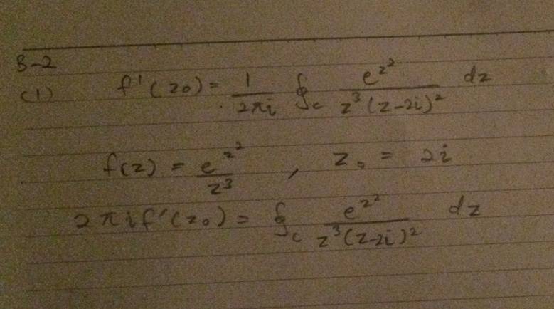

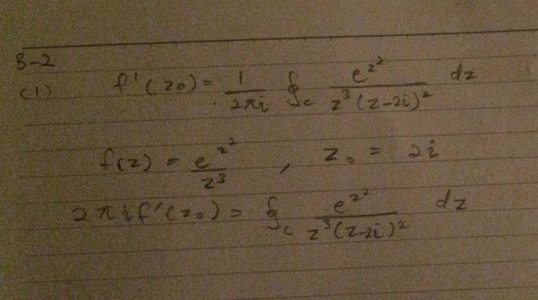

Your f(z) is different from mine. Is mine wrong?

In the first one, since the pole at z = 0 (I'm assuming that the unit circle is centred at the origin) is of order 3, you evaluate its residue using $\displaystyle \begin{align*} \textrm{Res}\,\left( f, c \right) = \frac{1}{2!} \lim_{z\to c} \frac{\mathrm{d}^2}{\mathrm{d}z^2} \left[ (z - c)^3\,f(z) \right] \end{align*}$.
Then the integral is calculated as $\displaystyle \begin{align*} \oint_C{ f(z)\,\mathrm{d}z } = 2\pi i \, \textrm{Res}\, \left( f, c \right) \end{align*}$.

What I undestood is that Your question (1) is to compute...
$\displaystyle \int_{\gamma} \frac{e^{z^{2}}}{z^{3}\ (z-2\ i)^{2}}\ (1)$
... where $\gamma$ is the unit circle... isn't it?...
Kind regards

Yes, but then why f(z) = exp(z^2)/(z-2i)^2 ? I don't understand.

I apologize because I've been in a hurry!... if You observe with care the general Cauchy formula I'm sure that it will be for You fully clear!...
$\displaystyle f^{n} (a) = \frac{n!}{2\ \pi\ i}\ \int_{\gamma} \frac{f(z)}{(z-a)^{n+1}}\ dz\ (1)$
Now suppose $\displaystyle f(z)= \frac{e^{z^{2}}}{(z-2\ i)^{2}}$ and a=0...
Kind regards
$\chi$ $\sigma$
