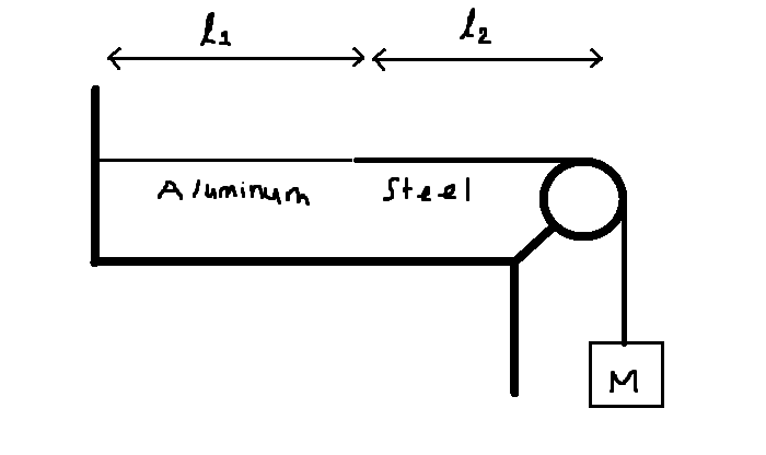

An aluminum wire of length l1 = 60cm, cross section area 1.00 x 10-2cm2, and density 2.60g/cm3, is joined to a steel wire of density 7.8g/cm3 and same cross sectional area. The compound wire loaded with a block of mass m = 10kg is arranged as shown so that the distance l2from the joint to the supporting pulley is 86.6cm. Transverse waves are set up in the wire using an external source of variable frequency. A node is located at the pulley.
a) find the lowest frequency of excitation for which a standing wave is observed to have a node at the joint.
b) How many nodes are observed at this frequency?
f = v/λ = nv/2l
ρ = m/V
v = sqrt(FT/μ)
Not too sure where to begin on this one. When it asks for the lowest frequency of excitation, I expect that means the second harmonic, because that would leave a node at the joint with the lowest frequency.
So knowing the densities of the wires, I can get v where
FT = μv2
FT = mg = 98N
μ = m/l = ρV/l = ρA where A represents the cross sectional area.
so μ1 = 2600*0.0001 = 0.26
μ2 = 7800*0.0001 = 0.78
v1 = sqrt(98/0.26) = 19.4m/s
v2 = sqrt(98/0.78) = 11.2m/s
so f = nv/2l
where n = 2 for the second harmonic
f1 = 2*0.26/(2*0.6) = 0.43Hz
f2 = 2*0.78/(2*0.866) = 0.90Hz
No idea if I'm approaching this correctly, due to the idea of reflection of waves at the joint.. Say a wave does reflect at the joint and a portion of it is sent back to the source, there would be a lot more waves thus being a much higher harmonic - not the second.
Any and all help appreciated. Thanks!
er ... that would be the case if the wave-speed is the same in each section of wire.
Think in terms of the modes in each section of wire, if the sections were separate.
Okay.. So if I know that
nv/2l = f
and am treating each section separately, except for the fact that frequency must be the same for each section, could I say that
nv1/2l1 = mv2/2l2
essentially setting frequency equal to frequency, but being able to solve for the number of nodes, or at least a ratio of nodes...?
as in
n/m = l1*v2/l2*v1
Thanks for the reply :)
Well done.
The other approach was to solve the wave equation directly :)
Thanks!
I don't see how I could solve the wave equation directly as you said, however. Can you define what you mean by wave equation?
Using what I mentioned previously...
n/m = l1*v2/l2*v1
n/m = 0.6*11.2/(0.866*19.4) which is roughly 2/5
So this means that the aluminum section, l_1, has 2 nodes and the steel section has 5 nodes, yes?
and frequency can be calculated by either side,
f = nv/2l
f = 19.4/0.6 = 32.3Hz
f = 5*11.2/2*0.866 = 32.3Hz
and the total number of nodes will be 2 + 5 = 7?
