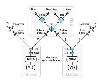

2. Sure, and the reference diagram is from here.
245955
a) In the various swapping experiments cited, entanglement of photons 1 & 4 occurs when photons 2 & 3 are cast via a Bell State Analyzer (the BSA is to be set at 0 degrees). The BSA is in the upper middle balloon of the diagram. The 1 & 4 pairs are spacetime separated, post selected, and the setup calls for the 1 & 4 to arrive at their beamsplitters near simultaneously (within a suitable coincidence window - so note that this is NOT the variation where the photons never coexisted). For simplicity, let's say we post select only those pairs that are psi+ entangled (same polarization when both measured at 45 degrees or any angle). By selecting 0 degrees for the BSA, and 45 degrees for the 1 & 4 pair, you can't learn anything about polarization of 1 & 4 when you perform the BSA on 2 & 3. The BSA on 2 & 3 rings either HH or VV for psi+, and again, the coincidence window is suitably small so that 2 & 3 are indistinguishable.
The 1 & 4 pairs will be matched in polarization about 100% assuming an ideal setup for the group we post select.
b) Now, we insert a 100 picosecond delay into the path of photon 2 (but nothing done to any of the other paths). The 1 & 4 pairs we want will still arrive within the requisite time window (relative to each other). But the 2 & 3 pairs will be easily distinguished as photon 2 will arrive about 100 ps later than photon 3. Importantly, we can still identify the 2 & 3 pairs as being either HH or VV as before, so that we can still post-select the proper 1 & 4 pairs. If there is local microcausality, as you claim, this modification should NOT affect the results at 1 & 4. (There is no causal connection between events at the BSA and detections at 1 & 4.)
But that is not the case. Instead, the 1 & 4 polarization matching will be about 50%, no correlation*. How is it that the same pairs arriving at 1 & 4 - which are spacelike separated - are suddenly giving Product state statistics rather than the Entangled state statistics? The only change was to the path length of photon 2, which is spacelike separated from photon 1 (and 4)? Because of the separation, there cannot be any causal connection between the decision to add the 100 picosecond delay and the matching between photons 1 and 4.
And yet this is all standard QFT. Which of course follows Bell, which rejects local determinism (a/k/a local realism). In case anyone is wondering if my version of this setup has ever been tested: EVERY entanglement swapping experiment demonstrates this! They always start with the 2 & 3 photons being distinguishable and then attempt to tune it to the indistinguishable version. When the 1 & 4 stats move from being Product state stats to Entangled state stats, they know they have succeeded. :smile: QED.*The stats would be as follows: The matches between entangled photons 1 & 2 will be 50% (i.e. random) due to the 45 degree separation in polarization angles being measured (cos^2 theta). Ditto for entangled photons 3 & 4. 1 & 4 are not entangled, and so their match rate will likewise be random. Of course, we are still only post selecting the portion that are denoted by HH or VV at the BSA.

Because when you add the delay, you are post-selecting different pairs of photons 1+4. Before you decide to add the delay or not, you can have the results of all the 1+4 measurements on a sheet of paper by your side (with randomly chosen HH or VV results). If the selections would be equal, what you are suggesting is that either the contents of the paper change based on your choice to delay or that your choice to delay is already determined based on the contents.
Or maybe I'm missing something - can you show that the same pairs are chosen in either case?
  • #37
The pair selection is the same. When any photons at the BSA hit a detector, a time stamp is recorded. Normally you would pick pairs that arrived within a 10 ps time window (or whatever). There won't be much outside that window as suitable 2 & 3 pairs (actually 4 fold coincidences) only come along every few seconds (perhaps 1500 in a 9000 second run). That makes the average time distance between pairs on the magnitude of a billion times the size of the window. It's practically a desert for coincidences between suitable pairs.
Now, if I add 100 ps to the photon 2 path, everything will else remain the same in terms of the relative ordering except that 1 of the BSA clicks will be marked as being between 95 and 105 ps later than the other. We would label that one as photon 2 - now clearly distinguished from photon 3. They would still be recorded as both H or both V. But if the one labeled photon 2 arrives that much later, we know it arrived still entangled with photon 1. Accordingly, no swap occurred, and it was not entangled with photon 4. Therefore, 3 & 4 were still entangled. You can work out the stats yourself, but the upshot is that 1 & 4 arrive at their respective 45 degree detectors with the same polarization HH or VV. Since they are not entangled though, we see Product state statistics for their matching rather than entangled state.
Considering that the decision to delay any particular photon 2 can be made before, after, or (near) simultaneously to the detections of photons 1, 3 and 4, it would require you to accept my central premise in the first place to believe that different 1 & 4 pairs are now selected. My premise being exactly that the entire context - which is clearly NOT locally causal (as there is no way to trace and/or otherwise assign causes and effects ) - must be considered to make a correct statistical prediction. Which is exactly what QFT says.

2. What's imho wrong with your argument thus simply is that you do NOT post-select the same ensemble with and without the delay you mention. To get 100% correlation for 1&4 you MUST not make 2&3 distinguishable. If you make the distinguishable you necessarily choose another sub-ensemble which necessarily doesn't show the correlations. In other words in this case you have not "swapped the entanglement".
Again there's nothing non-locally interacting here. It's just which subensemble you "post-select" to observe for the photons in the pair 1&4 based on what you observe (by local measurements) on the photons in the pair 2&3.
1. It's a contradiction. Established science is: Local determinism is excluded. As Demystifier says: "What does it mean "to prepare correlations"? Correlations of what? One cannot prepare correlations themselves. " You are going to have to provide a reference if you think QFT is local.
The entire point of this discussion is to clarify that with entanglement swapping variations - experiments that have been executed over the past 20 years by top research teams - there is no way to get back to a local description of what occurs. From the Zeilinger et al reference: "This shows that the independent photons [particles that do not share any common past ] in modes 1 and 4 clearly are entangled and can asymptotically be distilled into the maximally entangled singlet state...". They are in the singlet state, not just "correlated".
2. If the decision to entangle photons 1 & 4 is made at the last minute: please explain how that causes different 1 & 4 pairs to be selected. According to you, nothing changes there. ("there's nothing non-locally interacting here.") And presumably, 2 photons from independent sources (2 & 3) don't interact in your view either (regardless of whether they arrive at a beamsplitter simultaneously or not) . How could they? So how would different ensembles be selected?

Ad 1) How then can relativistic QFT be the best model of relativistic QT on the market, and it's not contradicting also the quoted Bell experiments, including entanglement swaping, teleportation, quantum erasures etc.
It's very clear what's correlated given the states your photons are prepared in. The photons from parametric down conversion are both correlated in momenta and in polarization. That's the very basis of all these experiments.
As I tried to explain for several times. The very quote by Zeilinger is fully consistent with standard QED. The partial ensemble of 1&4 pairs selected (or post-selected!) depending on local measurements on pairs 2&3 must be entangled, though the 1&4 never interacted. To be sure that they have never interacted you even need the microcausality argument since you can be sure about this only within the standard relativistic microcausal QFT according to which there are no actions a distance (i.e., causal connections between space-like separated events). Indeed they are not "just correlated" but even entangled, leading to stronger correlations than possible in deterministic local hidden-variable theories.
All your arguments thus rather confirm my arguments than disprove them!
Ad 2) It's said in the paper you quoted in the posting I was answering to: You must be sure to measure photons 2&3 within the coherence times/lengths of the photons to get the entanglement. If you make a time delay such that the "photons are getting dinstinguishable", then you don't exploit the correlations due to the initial entanglement of the pairs 1&2 and 3&4 anymore, because you are beyond the coherence "space-time inverval", and then the chosen subensemble of 2&3 doesn't select the same subensemble of 1&4 as before. As you say yourself, in this case one expects simply uncorrelated photons in 1&4 in this subsensemble. This is what I said in my previous answer too. Why you are claiming the opposite, I don't know ;-).

(a) The experiment considered here can be described as follows. There are two pairs of polarization-momentum entangled photons prepared, namely 1&2 and 3&4. The four-photon state at the beginning is thus given by the state ket
$$|\psi_{12} \rangle \otimes |\psi_{34} \rangle.$$
In full glory it's pretty lengthy to write. It's usually simplified as in the paper by only writing down the polarization part the experimenters are dealing with. However the full pair states also include the momentum part. If the polarization part is antisymmetric this must also be the case for the momentum part since photons are bosons. To fully discuss the experiment it may be important to once sit down and write this out completely, but it's understood implicitly also in the notation of the paper (which becomes clear by the figure discribing the experiment).
Anyway, due to the direct product, of course the photon pair 1&3, 1&4, 2&3, 2&4 are all NOT entangled.
However, when you make a selection by make a Bell measurement on photons 2&3 in the described way, particularly in a space-time region that is close enough together to be in the coherence lengths of all the photons, you can project (even long after the experiment is done as long as you have a complete measurement protocol with all the time stamps at place) to one of the possible Bell states for the pair 2&3. Here only local interactions of photons 2 and 3 are used, while 1&4 never have interacted in such a close region. Nevertheless due to the selection ensuring the entanglement of 2&3 due to being measured as being in one of the Bell states (the authors choose the polarization singlet state, but you can as well use any other of the four possible Bell states) for this subensemble 1&4 are now entangled.
Note that it's just the selection that leads to the entanglement. There's no non-local action at a distance at place since the meaurement on photons 2&3 (which must be close enough together in spacetime due to the coherence constraint) can well be space-like separated from the measurments on photons 1&4. You can post-select one of the Bellstates of 2&3 long after the entire experiment ist done and still find that the subensemble of photons 1&4 are correlated as described by their entanglement.
You are right in saying that the two entangled systems interact by just doing a local measurement on 2&3, because indeed 1&2 as well as 3&4 are entangled, i.e., they are "inseparable". That's the clue of the entire experiment! I however don't see why you say that there's anything non-local going on here. The interaction of the photons 2&3 with the measurment devices that enables you to select the wanted Bell state is local (in the sense of microcausality of QED).
