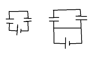

this is maybe one basic question, i drew 2 connections of capacitors, the left : connected in series. the right : connected in parallel ??
Two hand-drawn capacitor circuits side by side: the left has two capacitors and a battery in a single loop, the right has two capacitors in parallel across a battery in a second branch.
The left is in series, but the right is not in parallel. They are also in series (but they are short-circuited).
Two elements in parallel have the same starting node and the same ending node, and have the same voltage across them.
yes you are right, as the current splitted at the nodes will be constant through the 2 capacitors and the wire that doesn't carry capacitor is shorted

so is this a connection in parallel ?
Hand-drawn circuit schematic of two batteries connected in parallel, drawn between two vertical wires with a top and bottom wire, with one battery marked + and - at its terminals.
If you move the left capacitor along the wire to the top, if becomes obvious.

yes but i mean in this position they are in parallel also, because there are people that link parallel/series to exact position which is not totally right, the main thing that components having same current passed in them are series and others are parallel regardless of exact position
No, it's not "not totally right" it is totally wrong. You can always redraw circuits to look weird
Exactly.

i have a question, if we have one closed loop (with no nodes connected to more than 2 wires) and no battery in it, if we put in it any components at any position, they are always in series, right ?
No, because you don't know how the voltage source is going to connect to the circuit. If you place the positive terminal of a battery to any point in the circuit, but not the negative terminal, then they are now in parallel. For example, you could connect the positive terminal of the battery to the circuit, the negative terminal to ground, and have a ground elsewhere in the circuit to complete the connection.
does that mean that it is not right to decide for any connection having no battery if it is in series or parallel ?
The rule is rather simple: if they get the same voltage they're in parallel, if they get the same current they're in series.
