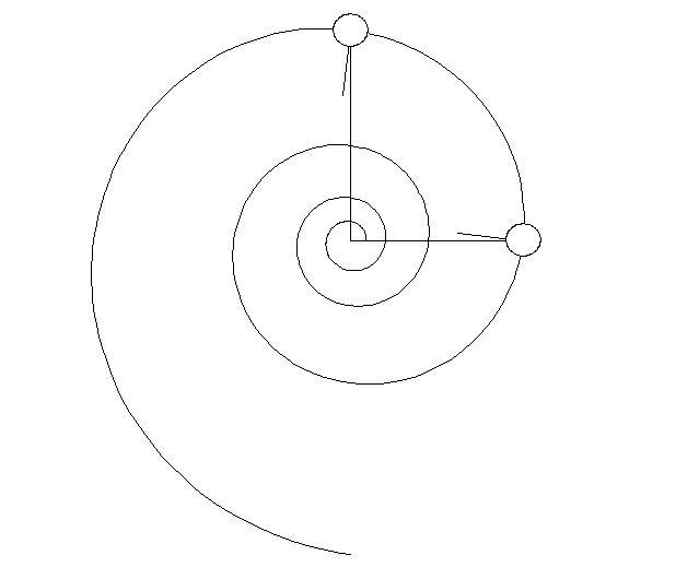

I have 2 questions about the situations below
http://img594.imageshack.us/img594/1/sadgsfdg.png
Let vcp be the initial tangential velocity required for the upper body for that, when the low body is released, the upper body describes a circular trajectory
I - In situation A, if we leave upper body with an initial tangential velocity (different from vcp), we have F2 ≠ F1
II - If the initial tangential velocity = 0, F2=F1
III - if initial tangential velocity is vcp, F2 = F1
IV - In situation B if we consider the pulley to have no mass we have F2=F1
a) Why do we have F2 ≠ F1 in case I and F2 = F1 in cases II and III ?
b) What would happen (the shape of the movement) if in situation A we had a pulley with mass=0 in the central hole?
**Note that the white circle in A has nothing to do with the trajectory of the upper body, it's just a circle
**There's no friction between any surfaces (only between the string and the pulley in case B, otherwise the string would slide in the pulley, not rotating it. But the pulley has no mass, so no energy is lost)
**Try to explain both qualitative and quantitatively
F1 is always equal to F2 in magnitude. The only difference between these situations is the accelerations of the masses. If the tangental velocity of the mass on the table is less than vcp, then the lower mass accelerates downwards, reducing tension in the string. Over a period of time, the upper mass will increase speed, and the system may reach a point where the lower mass accelerates upwards. Assuming no friction or damping factors, depending on the initial conditions, the system could oscillate between accelerating the lower mass downwards and upwards.
I don't think so. Let m = 1kg be the mas of the upper body, M=2kg the mas of the low body, R = 0.4m the initial radius and v0 = √0.8 the initial velocity (tangential) of the upper body (I got this numbers from an exercise).
We have conservation of angular momentum in the axis that passes trough the hole and is perpendicular to the table.
So v0.R = vt.r (vt is the tangential velocity and r is radius at that moment)
Let vy be the "centripetal" velocity of the upper body (velocity that point to the hole =-dr/dt). vy is equal to the velocity of the low body
Let ay be -d2r/dt2. ay is the acceleration of the low body
If a = F1/m, we have ay = ( a-vt2/r)/2 (I) (look at the picture below)
http://img824.imageshack.us/img824/9282/xgfghfdh.png
Conservation of energy:
MgR + mv02/2 = Mgr + m.vt2/2 + (M+m).vy2/2
Substituting vt = v0.R/r, substituting values, deriving in relation to time and dividing by vy we get
ay = 2/3 (10-(0.4/r)3)
So in the initial moment ay = 6m/s²
Now let's suppose by absurd that the forces were equal F1=F2 = F
In the initial moment:
Mg-F = M.ay
But by I we get ay = F/2-1
So 20-F = F-2 -> F = 11N
So ay = 4.5m/s², absurd.
So F1 != F2

jaumzaum said:
So all I want is that you guys find a mistake in my SECOND post. If there are mistakes there, then I can see that I'm wrong.
I'm can't follow the details of your derivation in your second post. But I don't believe your result for ##-\ddot{r}## is correct. You found ##-\ddot{r}= (1/2)(a - v_t^2/r)##, where I believe you are using ##a## to represent ##F/m##. There shouldn't be an overall factor of 1/2. You should have found ##-\ddot{r}= a - v_t^2/r##. Note that if ##v_t = 0## then you should get ##-\ddot{r}= a##.
It appears to me that in your diagram and also in the next to last line of your derivation you used the symbol ##a## where you should have used ##a_y## (or ##-\ddot{r}##). But I don't follow your derivation, so I'm not sure. It is not hard to derive the correct expression for ##-\ddot{r}## using polar coordinates. See here for a derivation. The result is that the total radial component of acceleration is
##a_r = \ddot{r}-r\dot{\theta}^2 = \ddot{r}-v_t^2/r##. So, ##-\ddot{r} = -a_r -v_t^2/r##.
In your problem, ##a_r## is what I believe you are calling ##-a##; that is, ##a_r = -F/m = -a##.
Anyway, if you use the correct expression ##-\ddot{r} = -a_r -v_t^2/r= F/m -v_t^2/r##, I think you will find that the tension is the same for both masses.
If the string is massless and there is no friction, then the the net tangential force on any small section of the string must be zero. Otherwise Newton's second law would say that the acceleration of that small section would be infinite.
So the tension on the string is constant end to end.
I've seen my mistake now, it's in the derivation process, you were right TSny. Thanks to everybody that helped me.
