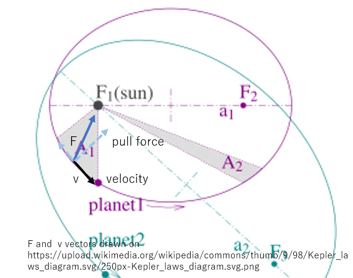

I would like to expalin it in the case of ellipse orbit of planets as shown in the figure below.
You see that F has components that is parallel and opposite to v. Therefore v is reduced.
The work done in small time dt by pulling force to the planet is
$$ dW=\mathbf{F} \cdot \mathbf{v} dt < 0$$
This corresponds to the case that the skaters extend their limbs.
