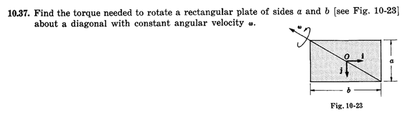

Perhaps this funny and simple problem can enliven the conversation :)
Sorry in advance if that is inappropriate
