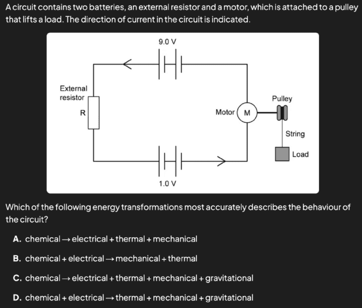

Correct energy transformation about circuit with EMF, a resistor and a motor

Please see below
Energy transformation
My answer is C (although I am not sure if the correct one is C or D). I suppose since the 1-V battery is being charged by the 9-V battery, the electrical energy should be on the RHS of the energy transformation. Am I correct?
Thanks
Given that you think that the correct answer is C, why did you exclude answer A? What's the difference between A and C?
Because the pulley lifts a load so I think there would be energy converted to GPE, which is not covered by option A
Thanks
What do you understand mechanical energy to be?
Hint: Read the first sentence here.
I thought the mechanical energy in this case maybe refer to something in the motor or pulley (like rotation). Is it not? So the correct answer should be A?
Thanks
Are you asking me or are you telling me? As you know, according to our rules we cannot give answers away.
I am asking, sorry.
My answer is still the same, it is C and the reasoning is this
Is my reasoning not correct?
Thanks
songoku said:
I am asking, sorry.
Thanks
I believe if you are adhering to the definition, then gravitational potential is a part of mechanical energy. Do you have definitions given to you of mechanical energy that say otherwise?
No, I don't. What I learned about mechanical energy is that it is the sum of potential and kinetic energy. I am only using my own interpretation that maybe this is some trick question so I tried to include whatever rotation in motor and pulley to be referred as mechanical energy and gravitational energy is treated separately
Thanks
`IMO none of the given answers are correct and the appropriate answer should be:
chemical → electrical → thermal + mechanical
