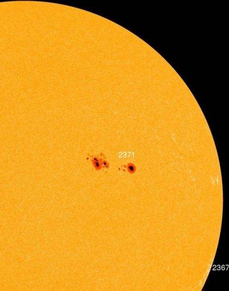

OK here's a couple of pix of the sun at the moment
the first one is a Hydrogen Alpha view and is very close to what you would see visibly through a telescope with a special filter to cut out most of the intense sunlight
This sunspot group has been causing a few flares over the last week and producing CME's resulting in aurora

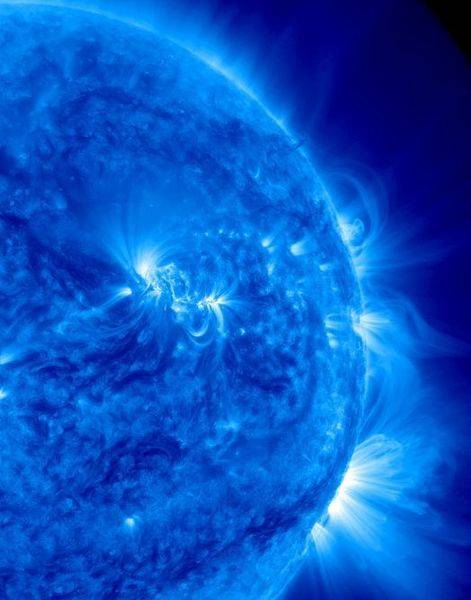

courtesy of Mt. Wilson Observatory 150-ft Solar Tower:This next image is of the same section of the sun using a detector that can detect an ionised Iron ( Fe) wavelength
with this one you can clearly see the magnetic field lines and loops being "traced out" by the plasma being held in the
magnetic fields ( just like when you put a bar magnet under a sheet of paper and sprinkle iron filings on top
maybe you did that at school in days gone by ?
courtesy of Solar Dynamics Observatory (SDO)cheers
Dave
