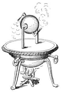

AmateurGuy said:
What if you could create thrust with water vapor the same way you could with the exhaust gas of a jet engine.
First done by Heron/Hero in the first century AD...
One issue is that water has a high latent heat capacity (2258kJ/kg) so it takes a lot of energy to turn it into steam. Depending on what you were trying to do it might be better to use liquid nitrogen which has a specific heat capacity 1/10th of that of water (199kJ/kg) but isn't so readily available :-)
