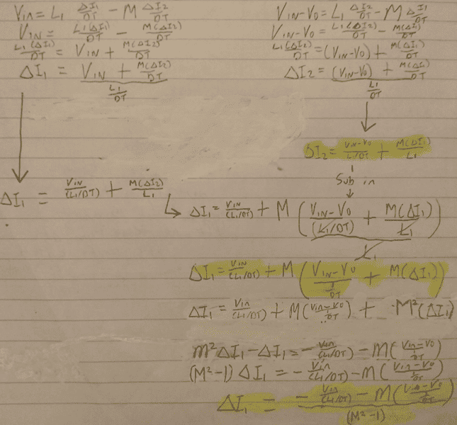

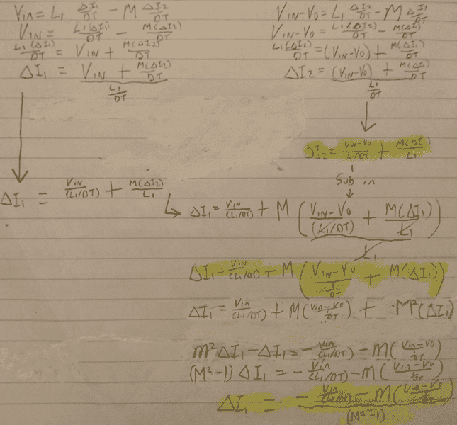

I am trying to calculate the ripple current in boost converter for ∆i1 and ∆i2 between time intervals between DT and T, and also dependent on the voltage level (Vin or Vin-Vout). To find a formula for ∆i1 and ∆i2, two formulas have to be derived for them. This is done from the equation:
Two equations for coupled inductor voltages: VL1 = L1 (ΔI1 / Time Interval) − M (ΔI2 / Time Interval) and VL2 = L2 (ΔI2 / Time Interval) − M (ΔI1 / Time Interval).
I derived equations for ∆i1 and ∆i2 as shown below, however I don't think this is right and I was wondering has anybody done this before that can provide some assistance, thanks!

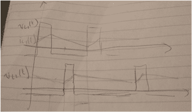

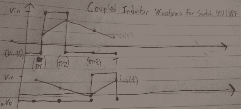

Below is a screenshot of VL1 and VL2, it shows the voltage and ripple current when the switch is either on or off due to interleaving. The only unknown variables from the formula mentioned in my previous post is ∆i1 and ∆i2, which is replicated by the red line in this photo. That is why I am trying to derive an expression for the two ripple currents, in order to find their value at each point, ie DT, T/2, DT+T/2, and T.
This question is for a boost converter that I am trying to design as part of an assignment.
