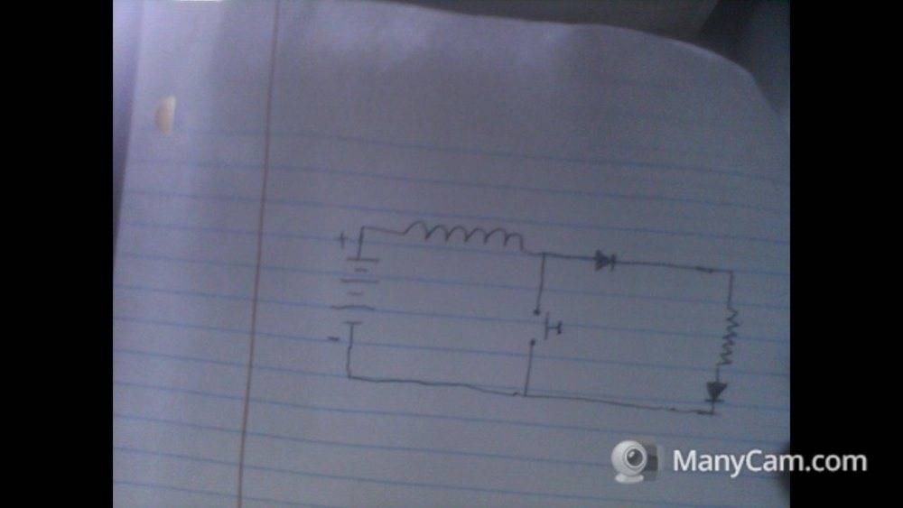

i have been researching how to build a boost converter. according to the articles i have read, when the switch is closed current flows through the
switch to the negative terminal. when the switch is opened, the back emf from the inductor and input voltage add, which forward biases the diode.
i am planning to use a lithium ion cell generating 3.7 to 4.1 volts. will that forward bias the diode, when the switch is closed. the diode is supposed to
be only forward biased when the switch is opened.
this is the circuit i am planning to use.
t
oh i forgot the second diode is a light emitting diode.
Boosting from a 3V source should be fine. BTW, you probably should add an energy storage cap at the output (in parallel with your load resistor and LED) -- that will make the calculations easier.
When the switch is closed, you are storing energy in the inductor. When the switch opens, as you say the EMF kickback forward biases the output diode and adds charge to the output capacitor.

so the battery won't forward bias the diode?
If you open the switch and let the circuit settle, yes it could put a small forward bias on both the rectifying diode and the LED. But that's not how a boost DC-DC circuit is used.

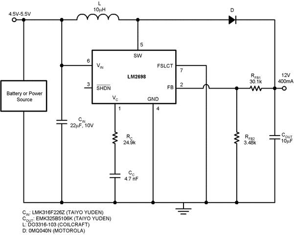

You could put a power switch in series with the battery to keep everything off until you are ready to turn the circuit on. Closing the power switch would provide power to the main current path for the Boost circuit, and also power up your switch circuit. What are you planning on using for your Boost transistor/switch control circuit?
http://www.ti.com/diagrams/custom_diagram_1_LM2698.gif

i meant, the battery won't forward bias the diode, when the switch is closed? when the switch is closed. why not

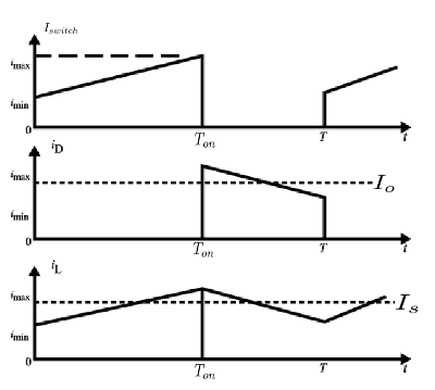

When the Boost switch is closed, that keeps any voltage from developing across the output (rectifying diode and load). This causes the current in the inductor to ramp up linearly according to:
[tex]V(t) = Vbatt = L \frac{di(t)}{dt}[/tex]

Use the Application Notes at the Simple Switcher website (used to be National Instruments, now is TI?). That will help you select the right Boost control IC and the external components. There are design calculators there, and they even give you links to the Digikey part numbers to order for the inductor and diode, etc. Couldn't be easier for a beginner, and you still learn a lot.
Have fun, and post your final circuit and results.
