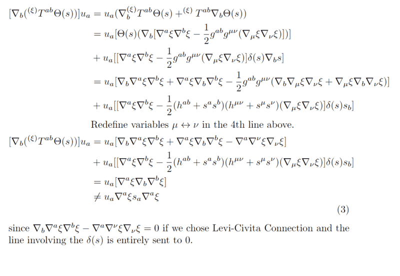

Hi all,
I am currently trying to prove formula 21 from the attached paper.
My work is as follows:
If anyone can point out where I went wrong I would greatly appreciate it! Thanks.
