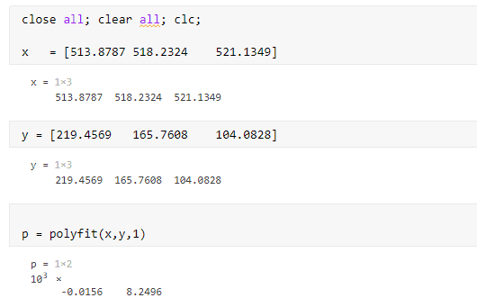

I did the first degree curve fitting in MATLAB. Please see below which also shows the output for each code line.
MATLAB script screenshot: clears workspace, sets x = [513.8787 518.2324 521.1349] and y = [219.4569 165.7608 104.0828], then runs p = polyfit(x,y,1), which returns p = 10^3 × [-0.0156 8.2496].

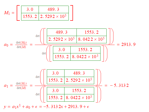

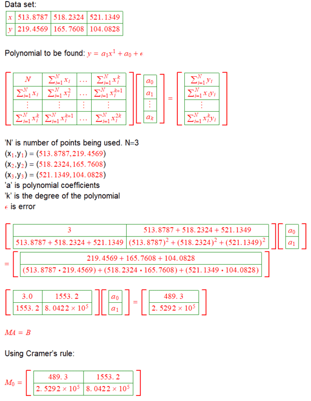

But I wasn't able to get the same answer using Cramer's rule method presented below. I'm sure MATLAB answer is correct so where am I going wrong with the Cramer's rule method. Could you please guide me?
Worked linear least-squares setup: data table of x and y values, normal equations with sums for N=3, matrix form MA=B giving 3.0, 1553.2, 8.0422e5, and Cramer's rule determinant for a0.
Worked Cramer's rule solution for a first-degree polynomial fit: M1 = [3.0 489.3; 1553.2 2.5292e5], a0 = det(M0)/det(M) = 2913.9, a1 = det(M1)/det(M) = -5.3132, giving y = a1x + a0 + epsilon.
Recheck your determinant calculations. What numbers do you get for det(M), and det(M0) and det(M1) ?
When I did those I ended up with the same results as the polyfit.

I did check but still got same numbers. I still cannot see what's going on with this method. Help, please!
det(M) = 229. 76
det(M0) = 6. 695×10⁵
det(M1) = -1220. 8
Try to go back and do your calculations without rounding off in the intermediate steps. I believe you are losing precision. In calculating these determinants, you have (Large Number) minus (another large number) = small number. 229 is pretty small relative to 8 x 10^5. Dropping a couple of digits at the trailing end will make a difference. 8.0422 x 10^5 = 804220. You have no knowledge about the one's digit, when multiplied by 3 could put you off by a value of close to 30, as just an example. And all of your data has 7 significant figures. Might as well keep (at least) that many digits, till the end.
Since your determinant of M is the denominator in all of these calculations, it can put the final answer off by factors.

I repeated the calculations in MATLAB using vpa() function and you were right it had to do with the precison.
Thanks for the patience and help!
