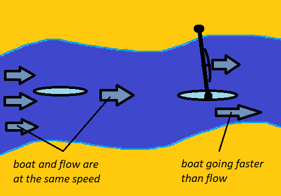

That is exactly how it works. That's why there is no fixed limit on the windspeed multiple a sailcraft can achieve, and this applies to the downwind component as well.
But there are practical limits. As you accelerate, the relative flow comes more and more from the front, so you need increasing high lift/drag ratios to still produce a forward force component (see post #57). The achievable lift/drag ratios for the interactions with the air and the surface are limiting the speed of a sailcraft.

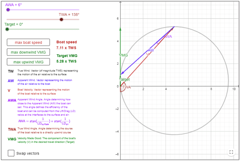

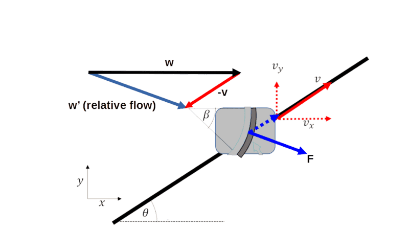

What about the vectors is wrong? The only assumption there is a lift/drag ratio of about 5, which is very conservative. Airfoils reach 20 and more.
If I gave the boat a shove in still air in the direction of the "true wind" in your diagram, that would produce relative flow over the air foil in the direction of the "apparent wind", that in turn would provide a force that accelerated the boat in the direction of the lift force (increasing its velocity), which would increase the sail force by way of increasing the apparent wind! ##\circlearrowright##. So in that case (absence of a drag force on the air foil - a function of the apparent flow velocity) the craft would accelerate away from me indefinitely. Now...add in the drag force. A drag force ( since you are talking about drag/lift ratio ) would grow (from 0) such that its component in the direction of the boats velocity matched the component of the lift force, thus accelerating away from me for a while, approaching moving away from me at a constant velocity.
In "still air" the "true wind" vector is zero. It doesn't have a direction. Can you draw vector diagram of what you mean?
If true_wind = 0 then apparent_wind = -boat_velocity. Since sail_force cannot be more than 90° from the apparent_wind, it cannot have a positive component in the direction of boat_velocity.
So if true_wind = 0 there cannot be a propulsive forward_force from the sail, no matter how much you push initially. There is nothing in the diagram that suggests it would accelerate without true_wind relative to the ground.
Your diagram is just arbitrarily drawn vectors that have scant applicability to a proper momentum transfer analysis. The wind applies a force to the sail. In Newtonian Mechanics we talk about forces, the wind force on the sail is not fully described by the wind vector in your diagram. The force on the sail depends on how it deflects the incident momentum from the wind. That is what determines which way and how much the boat accelerates.
The "apparent wind" in still air in your diagram would be the component of the boats velocity in the direction of the sail. That was your whole argument about scooping momentum from the ##y## direction by turning my vane clockwise 90 degrees. If there is apparent wind from me giving it initial velocity the airfoil produces lift. If there is lift ##\circlearrowright##. Perpetual motion ensues.
Yes, as shown in both bottom diagrams as sail_force.
erobz said:
... the wind force on the sail is not fully described by the wind vector in your diagram.
The sail_force direction is fully determined by the apparent_wind direction and the lift/drag ratio (assumed to be ~5 here).
Wrong. The vector math is:
apparent_wind = true_wind - boat_velocity
For true_wind = 0 you have apparent_wind = -boat_velocity. And since sail_force cannot be more than 90° from the apparent_wind, it cannot have a positive component in the direction of boat_velocity. So no acceleration is possible without true_wind.

There is no dot product here. It's just vector subtraction:

Maybe you misunderstand the sailing terms, so let me translate into in physics terms:
boat_velocity = velocity of boat relative to the surface
true_wind = velocity of airmass relative to the surface
apparent_wind = velocity of airmass relative to the boat
Thus per Galilean transformation the vector relationship is:
There is no projection involved.

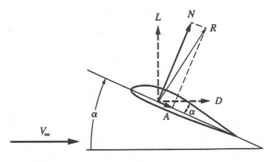

##\vec v## has components parallel and orthogonal, to ##\vec s##. It is the component of ##\vec v##, parallel to the chord ## \vec s## that is responsible for lift, hence the dot product.
You are confusing lift with normal force. Lift and drag are defined based on the relative flow direction (apparent wind), not based on the chord:
Difference between lift (L) and drag (D) versus normal force (N) and axial force (A)
From: https://aerospaceweb.org/question/aerodynamics/q0194.shtmlThe direction of the apparent_wind is not affected by how you orient the sail, just by true_wind and boat_velocity per Galilean transformation:
the apparent wind is coming in the direction of ##\vec A##. In the case of no wind it is equal in magnitude opposite in direction to the component of ## \vec v ## in the direction of ##\vec A## ( ##\vec s ## in my diagram ).

No, your ##\vec s ## (sail orientation) is completely irrelevant to the apparent wind direction. Only the relative velocities matter in the Galilean transformation:
Note that these are free stream velocities, not the air motion deflected by the sail. But that is also how lift is defined: as perpendicular to the free stream relative flow.

On the contrary. The apparent_wind vector in my diagram is very important for the sail_force, as already explained:
But it seems you fail to understand that apparent_wind is not defined based on the sail orientation, but on the motion of the freestream airmass in the rest-frame of the boat. It's a function of boat_velocity and true_wind only.
The sail in the diagram is just for informal reasons, shown roughly how you would orient it to maximize lift/drag ratio. But the motion freestream airmass is not affected by the sail setting.

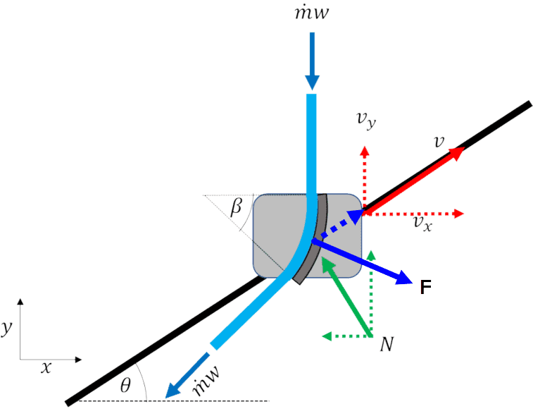

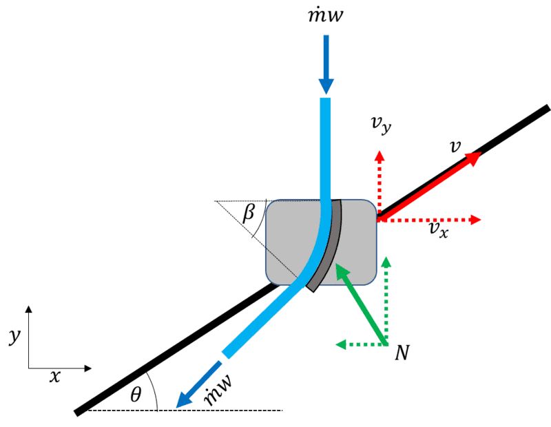

I've shown (I believe correctly) in the vacuum of space a cart on a frictionless track can't outrun the jet of fluid pushing it with momentum change. Obviously, the models are absent the force of lift. Turning the vane around clockwise 90 deg. ( as you suggest) is detrimental to your argument. The momentum change goes from applying a force ##\nearrow## to applying a ##\searrow## to the cart.
If lift is somehow the answer, it's a long way from where I'm at.
Oh, and to one of your earlier posts about modeling the thickness of the jet ( you said something like the thin jet was the problem and I needed a thick one) The "wind" would be analogous to an array of jets, which the cart was intersecting as it passed by, taken in the limit as the distance between each jet goes to zero, we get a reasonable approximation for wind in my opinion.

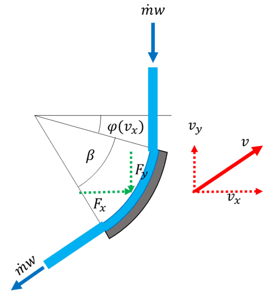

I 've shown ( I believe correctly) in the vacuum of space a cart on a frictionless track can't outrun the jet of fluid pushing it with momentum change.
If you insist on using a thin jet, then you have to make your sail very large instead. This would look something like this animation

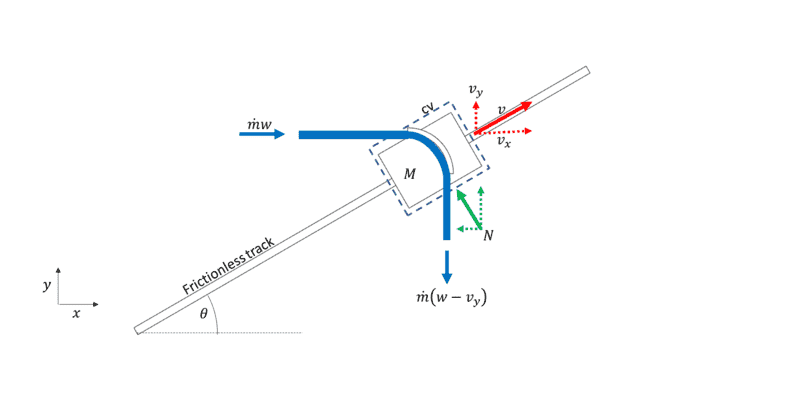

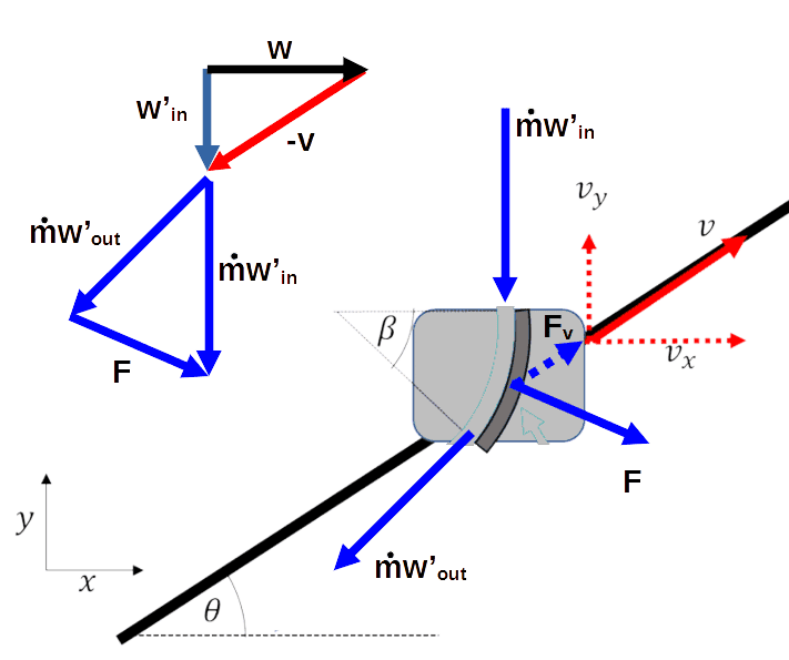

But a ##\searrow## force will propel your cart forward, if ## \theta < 45° ##. And this will also happen when ## v_x = w ##, where the relative flow into the vane is along negative y direction. Of course you need a wide jet here, like the actual wind. To go even faster you have to turn the vane further clockwise, and make it less curved. As already explained, deflecting the air by 90° is very inefficient.

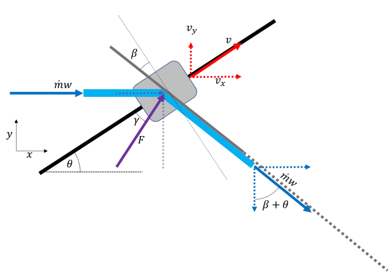

I'll solve for 45 degree turn tomorrow. Im burned out.
Just to be clear, I meant ## 0° < \theta < 45° ##. For the ## v_x = w ## case you can keep your 90° deflection vane, just rotate it by 90° clockwise, so it deflects the relative flow from -y to -x.
It should be obvious right away that this slows down the air relative to the ground, so it removes energy from the ground-air system.
